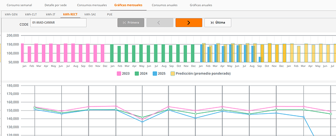

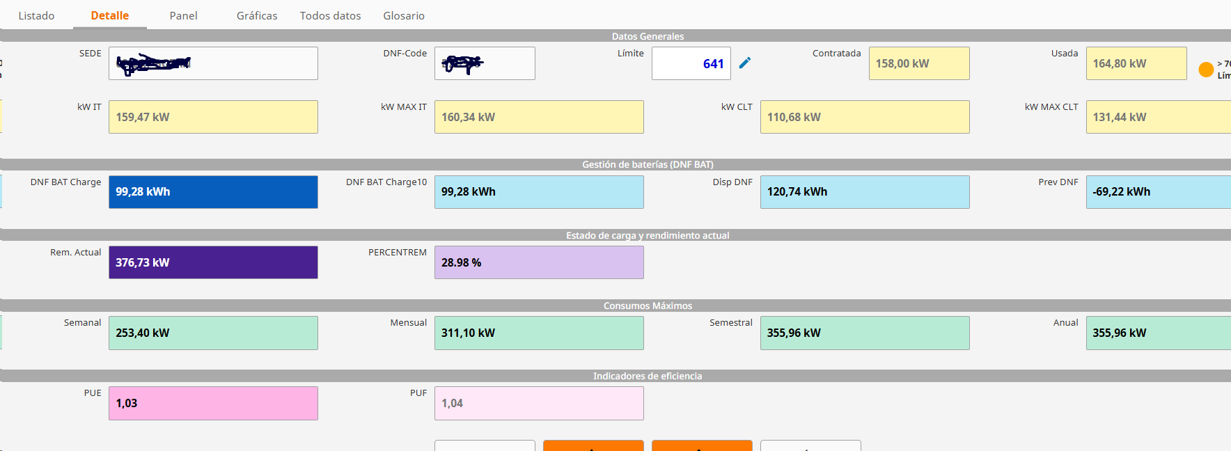

Here are some parts I can share of our project.

As you see we use a lot of colors, no worries, they are all corporative colors. help us to see well the data.

Congrats for your project, I like the colors you use. Is very easy to read!
One question, what charts have you used in the last picture?
**Author:** ![Alejandro\_Alaco](https://sea1.discourse-cdn.com/inductiveautomation/user_avatar/forum.inductiveautomation.com/alejandro_alaco/32/59849_2.png) [@Alejandro\_Alaco](https://forum.inductiveautomation.com/u/Alejandro_Alaco)\
**Post date:** [September 19, 2025, 9:24am UTC](https://forum.inductiveautomation.com/t/project-screenshots-share-yours/513/277 "2025-09-19T09:24:50Z")
Thanks,
i did that using a XY chart on render line mode using two different datasource for each year with 2 different series you can customize, once you have different seriex you create different xAxes and yAxes for each of them .
 ![image](https://us1.discourse-cdn.com/inductiveautomation/original/3X/8/5/85be26de07aac1f3c2667ffc568cb62f97b15dda.png)
 ![image](https://us1.discourse-cdn.com/inductiveautomation/original/3X/b/3/b3dd8d113ae947ff7d965090b08b6440bdd709fa.png)
 ![image](https://us1.discourse-cdn.com/inductiveautomation/original/3X/d/5/d51c03c806373a7f5cbd6b755ca7d886d4627017.png)
Is important also to calculate the range minimum and maximum ob both charts,
First calculate the maximum and minimum of each chart so later you calculate the max and min of both.
 ![image](https://us1.discourse-cdn.com/inductiveautomation/original/3X/c/b/cb0276d8e0c7d7a69e4418ccd2d677c2a2064782.png)
This way you can overlap as many charts ad you want.
Cheers.
