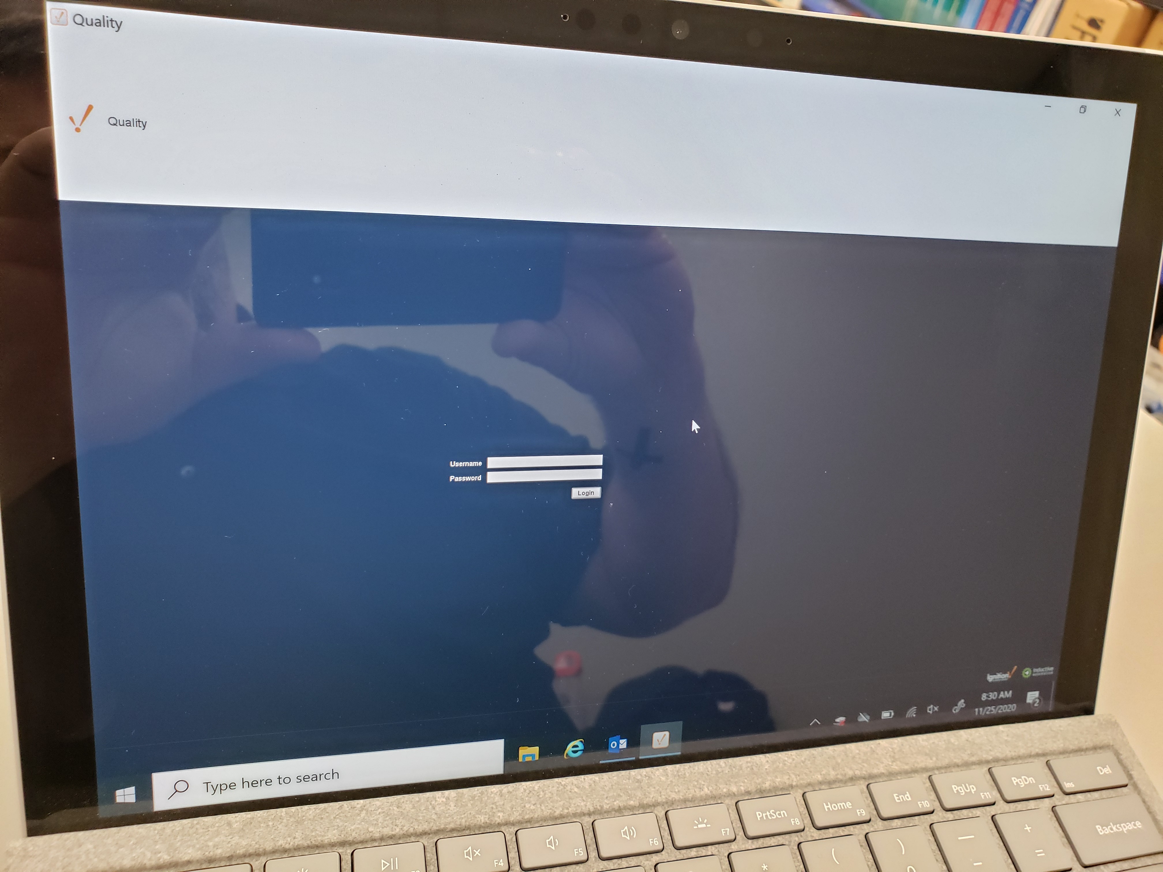

**Author:** ![toddayers](https://avatars.discourse-cdn.com/v4/letter/t/8baadc/32.png) [@toddayers](https://forum.inductiveautomation.com/u/toddayers)\
**Post date:** [November 25, 2020, 3:39pm UTC](https://forum.inductiveautomation.com/t/project-size-on-different-devices/40956/4 "2020-11-25T15:39:24Z")
![login window](https://us1.discourse-cdn.com/inductiveautomation/original/3X/3/2/322c235fb0770a98572ff15ab71f084f3fae412f.jpeg)
It’s hard to see in this picture how small they are, but relative to the tool bar on the bottom they are very small.
**Post date:** [November 25, 2020, 4:14pm UTC](https://forum.inductiveautomation.com/t/project-size-on-different-devices/40956/5 "2020-11-25T16:14:35Z")
It looks like the surface is doing DPI scaling that, for whatever reason, Swing isn’t aware of.
You could try adding `-Dsun.java2d.uiScale=2.0` to the client launcher arguments section - 2.0 would mean 200% - you should probably check Windows’ display settings to confirm the correct value.

**Post date:** [November 25, 2020, 5:13pm UTC](https://forum.inductiveautomation.com/t/project-size-on-different-devices/40956/9 "2020-11-25T17:13:01Z")
Oh that’s great news (for me, anyways 🙂 ) - I saw the icon on the taskbar and assumed 8.0+ for some reason.
Java 8 doesn’t respect Windows’ DPI settings, full stop. Starting in Java 9 there _is_ support - so since you’re on 7.9.13, you can download the native client launcher from the gateway homepage, and launch your client from there. That _should_ use the embedded Java 9 runtime we started shipping in later 7.9 versions, and thus should automatically resolve this UI scaling problem.
**Post date:** [November 25, 2020, 5:17pm UTC](https://forum.inductiveautomation.com/t/project-size-on-different-devices/40956/10 "2020-11-25T17:17:32Z")
Yep, that worked!!
