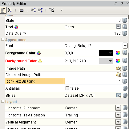

Can I get an explanation as to why Background Color is in red?
Thank you.

I just got this to happen if I configured the style customizer on the component as well trying to bind a value to the single property.
You should only have 1 source attempting to set the value- otherwise it alerts you that there are 2+ controlling factors.
