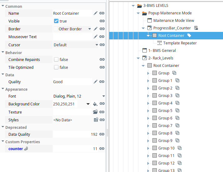

I have a customProperty called counter that increments every second
I want that when it reaches 10sec, it closes the page... what am I doing wrong?
```auto
if event.propertyName == 'counter':
        if event.newValue == 10:
            system.nav.closeWindow('2-DEVELOP/2-SYSTEM/3-BMS LEVELS/Popup Maitenance Mode/ProgressBar_Counter')
 ![image](https://us1.discourse-cdn.com/inductiveautomation/original/3X/2/b/2b31fa0b3f1098c2e1aad734c94a9300750a6f64.png)

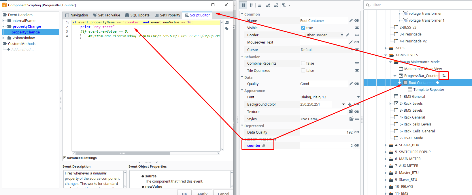

Did you create the customPropertie inside the root.container of the window where we are making the script?
 ![image](https://us1.discourse-cdn.com/inductiveautomation/original/3X/d/7/d7819fb64c855a1b76738f20ff7fabcccf7ded65.png)
**Post date:** [February 12, 2024, 4:32pm UTC](https://forum.inductiveautomation.com/t/propertychange-does-not-work-for-me/85556/8 "2024-02-12T16:32:41Z")
The event must be on the root container, not the window, if you are monitoring a root container property. Putting the event on the window will only catch changes to the **window's** own properties.
**Author:** ![Miguel\_Cimildoro](https://avatars.discourse-cdn.com/v4/letter/m/53a042/32.png) [@Miguel\_Cimildoro](https://forum.inductiveautomation.com/u/Miguel_Cimildoro)\
**Post date:** [February 12, 2024, 4:41pm UTC](https://forum.inductiveautomation.com/t/propertychange-does-not-work-for-me/85556/9 "2024-02-12T16:41:04Z")

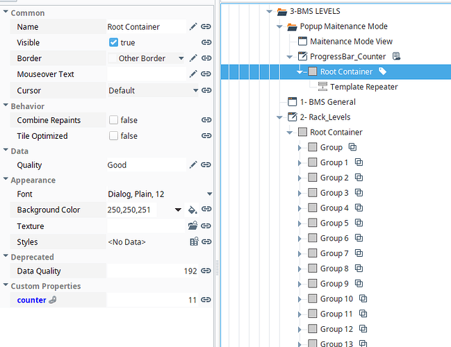

I don't understand, if I want a window to close when a counter (customProperty) is equal to 5 (that's what I want to do). I have the custom created inside the root container of the PopupWindow and it is that custom that I am trying to interact with the closing of the window.
**Post date:** [February 12, 2024, 4:46pm UTC](https://forum.inductiveautomation.com/t/propertychange-does-not-work-for-me/85556/10 "2024-02-12T16:46:13Z")
A property change event is only sent to the component that has the property. The root container of a window **is not the window**. Move your event script to the root container.
**Post date:** [February 12, 2024, 4:50pm UTC](https://forum.inductiveautomation.com/t/propertychange-does-not-work-for-me/85556/11 "2024-02-12T16:50:30Z")
omg!!! now I see it... indeed that was... thank you very much for the class Phill! I learned a lot with that explanation.
