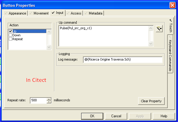

Hi, I’m working on a Citect project and migrating its functionality to Ignition Perspective. I came across a button-click event in Citect called **“Pulse”** , which is a built-in function used to send a short pulse to adjust a motor.
Is there an equivalent feature in Ignition, or a recommended way to replicate this behavior? I couldn’t find any built-in delay or pulse function.
 ![image](https://us1.discourse-cdn.com/inductiveautomation/original/3X/5/f/5f910bf7455f5566bd9e902b127a2a816ff4cc19.png)
Thanks in advance.

> [@Perspective: Scripting a Momentary Button](https://forum.inductiveautomation.com/t/perspective-scripting-a-momentary-button/35684):
> Hey folks, Ignition 8.0.7 I’m trying to implement a momentary button in Perspective, but the feature doesn’t appear to be available. The One-Shot Button documentation states, [“If your PLC expects the HMI to reset the bit, use the Momentary Button.”](https://docs.inductiveautomation.com/display/DOC80/Perspective+-+One-Shot+Button) Since it seems as though the feature is not yet supported, does anyone have an example script for the button component that can reliably perform the Momentary function? I’m having a hard time replicating the function of the momentary button from Vi…
This is a typical momentary button. This is also a bad idea. This leaves the system open to the button getting latched on and never reset. This is also a problem with Citect. I recommend you modify the PLC logic slightly to make the PLC reset the bit after a latch from the SCADA, its much better and less error prone.
