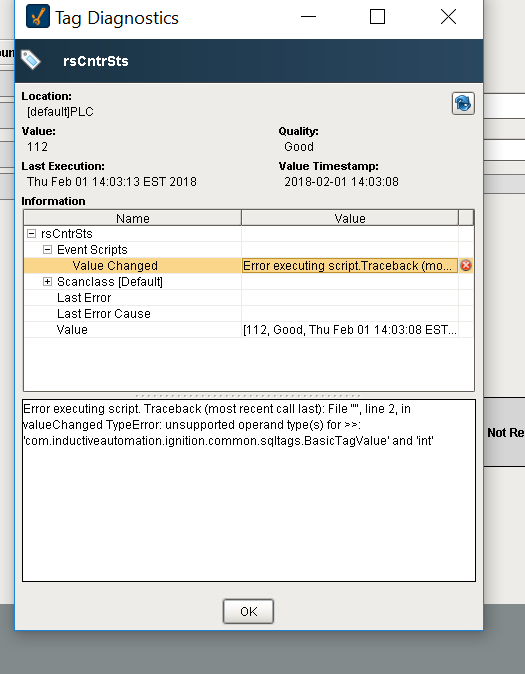

Hello All:
I am trying to extract bits from integer by using simple python script as shown below:
vaule=currentValue\>\>(7&1)
system.tag.write(“PLC/SensorFailure”, currentValue)
This script works with Python IDE (2.7 and 3.x) both, but it is giving me error as shown in the attachment
 ![](https://us1.discourse-cdn.com/inductiveautomation/original/2X/1/10f6d23bfca4b4d202bf3a3502039e616b8fe7f8.PNG)
Could you please let me know what is the problem
Thanks,
Shwetha.

currentValue is not a primitive value. It is a BasicTagValue. To get the actual value as a primitive, in this case, you need to go something like this, using your example:
```auto
vaule=currentValue.value>>(7&1)
**Post date:** [February 1, 2018, 7:49pm UTC](https://forum.inductiveautomation.com/t/python-scripting-question/16841/3 "2018-02-01T19:49:02Z")
If you read the comment section at the top of the script you will notice that:
> currentValue: This current value. This is a "qualified value", so it has value, quality, and timestamp properties.
Try using currentValue.value.
EDIT: Kyle beat me to it. 😉

Thank you, Both. It works.
