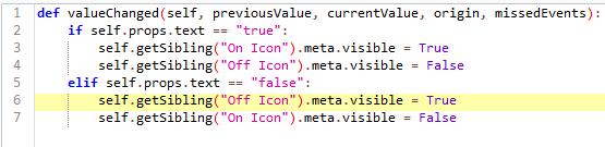

I am working on a project to show the status of assembly lines, whether they're scheduled or not. I have the tag set up properly and the text is showing "true" when it's scheduled and "false" when it isn't. I am trying to set up an icon to appear depending on the status. (toggle\_on for scheduled, toggle\_off for unscheduled). Here is the change script that I've written:
![image](https://us1.discourse-cdn.com/inductiveautomation/original/3X/b/7/b7aac20372132a94086d11ac625c2f30b00ecac5.png)
I can't get the visibility on the icons to work correctly, so I know I must be doing something wrong. Any suggestions?

Why would you do it this way, instead of binding the tag directly to the visibility prop?
Is the tag a Boolean tag?

I'm new to Ignition, this project is me teaching myself how to do it. I have some help here in my office, but we're the only ones.
I didn't even know I could bind it directly to that prop! I'll try that and see if it works.

Irose, thank you so much! I just got it to work.
