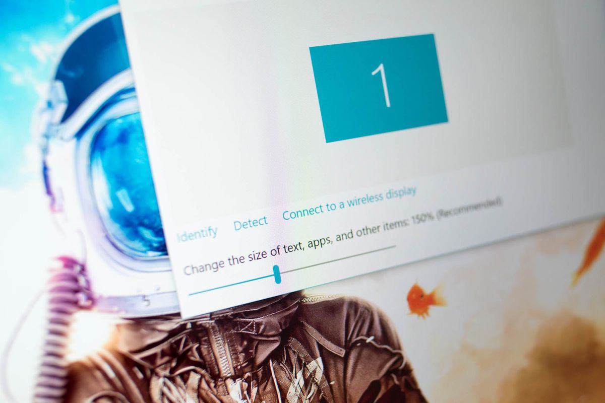

> Is there a way to increase the X button (screen close) size?
When you say the "screen", what are you talking about? The Client application? If so, that's determined by your OS settings. In Windows you can change the scaling of all applications, but this will essentially reduce the screen resolution for your Ignition client Windows as well..
> **[How to make text, apps, and other items bigger in Windows 10](https://www.windowscentral.com/how-make-text-apps-bigger-windows-10)**
> You can make the text and other things like icons larger in Windows 10. You can choose to resize everything in one fell swoop or temporarily resize with the Magnifier. You can also ...
