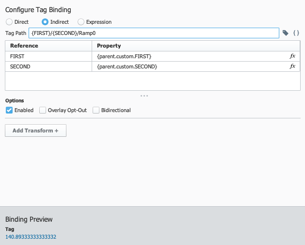

I am trying to set up an indirect tag reference in Perspective which uses two custom properties that I have defined in the root directory of the view I am working in. I am able to browse to the two custom properties and add them in to the tag path, but I keep getting “Error\_InvalidPathSyntax” in the binding preview.
The tag path I am using looks like this: {OPC\_ChannelName}/{OPC\_DeviceName}/LastStopVariable
The tag path works when I use it as a direct tag like:FWD\_G\_Omron/Machine01/LastStopVariable
I have the custom property values set to: OPC\_ChannelName = FWD\_G\_Omron; OPC\_DeviceName = Machine01
Right now, I am on the nightly build from yesterday. Is there something I am missing, or could this be a bug?

It might help us to have some more specifics about your environment as I was able to implement an indirect tag binding without issue with a simulation device. Are you using a trial or the provided license? Is your Omron device status showing as connected?
For my View, `parent.custom.FIRST` resolves to a custom property on the root container.
 ![](https://us1.discourse-cdn.com/inductiveautomation/original/2X/d/d4ddbc613f3b227f7886eebdf4c42ec4fbe2782f.png)
I noticed that your example has a semi-colon as part of `OPC_ChannelName = FWD_G_Omron;`. Is that semi-colon part of the text value, or was it included as a delimiter for the values you provided? If the former, please try removing it and see if that changes your result.
