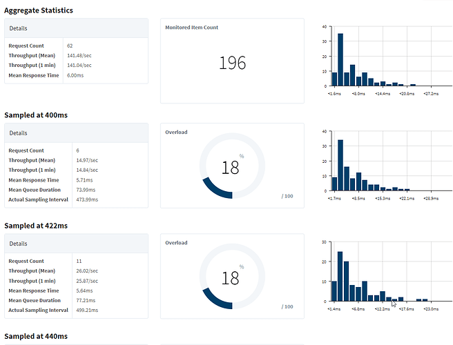

TL;DR: Tags overload on the S7 driver seem to oscillate at random, how to proceed to diagnose what's causing a device's communication to overload and how to best configure tags to avoid it.
Using the S71500 driver over the last week and a half i've been having issues where i set some tag groups at around 250ms to 450ms and things look great with an overload of around 10% max, the UI is really fast and responsive. Then the next day comes(or sometimes within an hour) and suddenly they're all at around 95%~200% overload, even when i raise their rate, eventually it happens again on the new slower rate so the rates don't seem to be directly correlated to it.
My main goal is to find the source of this rise of overload since it happens seemingly at random times and with all sample rates even when nothing changed on the gateway.

To illustrate the problem, these screenshots were taken a few hours apart.
 ![image](https://us1.discourse-cdn.com/inductiveautomation/original/3X/4/f/4f05bf42593fb7e70ae4aa11521c3e5cb9fb0e6c.png)
~8AM.
 ![image](https://us1.discourse-cdn.com/inductiveautomation/original/3X/1/c/1ca72849c3a84f772b2d63abb8eba4b3189c6a90.png)
~11AM
The other tag groups that aren't shown in the screenshot were at around 90~110% overload.

**Post date:** [July 5, 2023, 8:23pm UTC](https://forum.inductiveautomation.com/t/questions-on-how-to-avoid-communication-overload-with-a-siemens-s7-1500-plc/75961/2 "2023-07-05T20:23:47Z")
I'm not a Siemens guy, so have no specific advice, but you should know that **any** non-zero overload value means you are not meeting your target polling rates. Having a PLC always in overload means there's no leeway to handle non-polling messages (like writes, or traffic from devices outside Ignition).
Sounds like you have a design flaw to me.
**Post date:** [July 5, 2023, 8:48pm UTC](https://forum.inductiveautomation.com/t/questions-on-how-to-avoid-communication-overload-with-a-siemens-s7-1500-plc/75961/3 "2023-07-05T20:48:45Z")
Can you copy/paste the full stack trace you get after clicking "+" to expand one of those errors? Don't think it's related, but curious.
The tag group rates you're using are not doing anything but making it harder to absorb the diagnostic info. There is no practical difference, you should just put all the "fast" tags into one 450ms or 500ms group.
I don't know if there's any reason _not_ to use both the S7 and OPC UA connection. Seems fine to me? 🤷‍♂️
Are people online with the programming software at times when the polling slows down? It does look like it could be on the PLC side since the response times appear to slow down in your later screenshots.

**Post date:** [July 5, 2023, 9:06pm UTC](https://forum.inductiveautomation.com/t/questions-on-how-to-avoid-communication-overload-with-a-siemens-s7-1500-plc/75961/7 "2023-07-05T21:06:34Z")
Ok cool, just making sure we're on the same page. If it's like every other PLC programming package then being online with the controller can impact comms.

**Post date:** [December 14, 2023, 1:30pm UTC](https://forum.inductiveautomation.com/t/questions-on-how-to-avoid-communication-overload-with-a-siemens-s7-1500-plc/75961/10 "2023-12-14T13:30:09Z")
Just a generic solution: Don't do too much or too fast with a lame PLC. Any external comms puts load on the PLC, including use of PLC programming tools.
(That Siemens permits external comms load to affect cycle time in what is _ **supposed to be** _ a real-time industrial system simply boggles my mind.)
