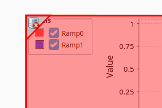

How do I find out what the error in the upper left is?
 ![image](https://us1.discourse-cdn.com/inductiveautomation/original/3X/b/5/b5c5d806ccc7892c2068d5fd14181b044b3eabdf.png)
**Post date:** [October 2, 2025, 9:17pm UTC](https://forum.inductiveautomation.com/t/quick-chart-works-in-designer-but-has-an-error-in-runtime/111163/2 "2025-10-02T21:17:42Z")
> [@Tag History on Chart (only working in Preview)](https://forum.inductiveautomation.com/t/tag-history-on-chart-only-working-in-preview/95053/2):
> Check the project permissions for tag history:

Thank you, you are the coolest!
