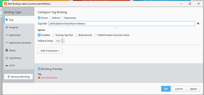

I am trying out 8.3 and I’m wondering whether there is a way to read all properties of an Alarm Metrics instance or not.
Obvisouly, with some tests on my end this does not seem doable as it appears you have to specify which property you want to subscribe to in order to get actual data
 ![image](https://us1.discourse-cdn.com/inductiveautomation/original/3X/5/8/58441d7c564da82194dc09cd6d9deefdfeb0bf7c.png)
 ![image](https://us1.discourse-cdn.com/inductiveautomation/original/3X/c/1/c18b70df0c48c63643131b3b3260321d8b2eb458.png)
Sadly, for my use case I need to get two properties of the Alarm Metrics (highestActivePriority and highestUnackedPriority) , is there no way other than creating 2 bindings on every view where I want to show a border related to Alarm metrics?
For instance, if you specify the path of an instance, you can get the value of all the variables as a dictionary. This does not seem to behave the same for Alarm Metrics.

Don't do it. There is nothing `tag()` does that cannot be done with a UI custom property that has an indirect tag binding. Using `tag()` in a UI binding may seem like a solution, but you are setting up yourself (or your successor) for misery. Let me rephrase:
Do not use `tag()` in any UI binding. Full stop.

> [@Samuel\_Sueur](#):
Create two custom tags and do the bindings on each of those then use those wherever you need as an expression binding. It's simple and it works and it's a lot less overhead than you expect.

**Post date:** [January 14, 2026, 5:34pm UTC](https://forum.inductiveautomation.com/t/read-all-alarm-metrics-data-in-one-binding/113275/12 "2026-01-14T17:34:21Z")
Why not just... one expression binding?
`{path/to/tag.Alarm Metrics.highestActivePriority} > 2 || {path/to/tag.Alarm Metrics.highestUnackedPriority} > 2` (or whatever).

Hi Paul,
Thanks for your suggestion.
My bad, in my screenshots I showed a direct tag binding, but what I am looking for is really an indirect tag binding, as the view would generally have a `path` parameter in input.
I guess what I’m after isn’t really doable so I’ll just have to create two indirect tag bindings in order to show a blinking alarm border or not depending on the alarm metric properties and whether there are unacked alarms or not.
