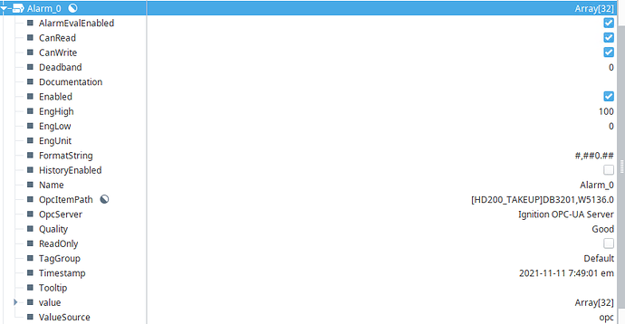

Hi,
I try to read a Siemens word where each bit represents an alarm into a boolean array.
I set the OPC Item path to [HD200\_TAKEUP]DB3201,W5136.0 and expect to get an array with 16 elements. But instead I get 32?
 ![image](https://us1.discourse-cdn.com/inductiveautomation/original/3X/0/e/0ea8eb708a68dd16eee11b2628e6419afb1088c0.png)
I tried to read a byte instead using [HD200\_TAKEUP]DB3201,B5136.0, then I got 16 elements in the array.
What am I missing here?
Why do I get the double size than what I expect in the array?
/Erik
**Post date:** [November 11, 2021, 2:54pm UTC](https://forum.inductiveautomation.com/t/read-siemens-word-into-boolean-array/52963/2 "2021-11-11T14:54:04Z")
> [@erik.forsgren](#):
This syntax is incorrect. You're asking for bit 0 of that word, then letting Ignition turn that bool into an int, then casting that int into a bool array.
The word is just `[HD200_TAKEUP]DB3201,W5136`

**Author:** ![erik.forsgren](https://sea1.discourse-cdn.com/inductiveautomation/user_avatar/forum.inductiveautomation.com/erik.forsgren/32/14156_2.png) [@erik.forsgren](https://forum.inductiveautomation.com/u/erik.forsgren)\
**Post date:** [November 11, 2021, 2:59pm UTC](https://forum.inductiveautomation.com/t/read-siemens-word-into-boolean-array/52963/4 "2021-11-11T14:59:22Z")
Thanks, I removed the .0 from the address. And get the same result as before.
 ![image](https://us1.discourse-cdn.com/inductiveautomation/original/3X/7/5/7523dba6182f727352a439499280fea801601a55.png)
**Post date:** [November 11, 2021, 4:27pm UTC](https://forum.inductiveautomation.com/t/read-siemens-word-into-boolean-array/52963/5 "2021-11-11T16:27:38Z")
A Siemens Word is unsigned. Ignition’s tag system doesn’t have unsigned values, so it’s delivered to the tag system as a value the next size up - a signed integer. You’re then telling Ignition to treat it as a bool array.
Try addressing it as Signed Int instead: `[HD200_TAKEUP]DB3201,I5136`
Or just ignore the last 16 bools.
