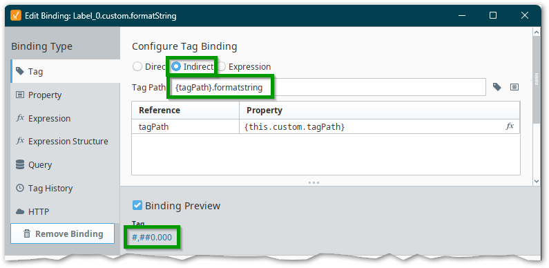

3. Create an indirect tag binding on `custom.formatString`.
 ![image](https://us1.discourse-cdn.com/inductiveautomation/original/3X/f/3/f372da2988df622d7c28368d5a67c9584c77f091.png)

Expression: `numberFormat({this.custom.tagValue}, {this.custom.formatString})`
You should now be able to copy the label as often as required, set the tagPath and everything should work.
