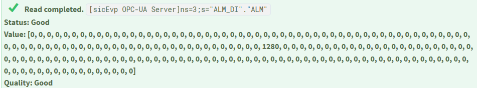

I’m reading OPC Client values from PLCSIM Advanced. Everything was going ok until an array appeared.
On the gateway, I can read these values in the Quick Client with good quality, but when I try to add it to the project I get an error configuration.

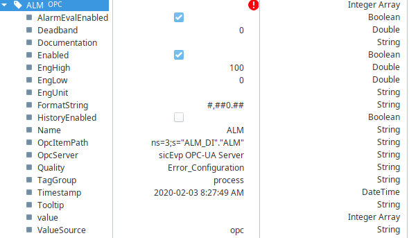

 ![image](https://us1.discourse-cdn.com/inductiveautomation/original/2X/4/47a8381a05b76bec8bd74229b13c01b9e28de01a.png)
I tried every type of array available even dataset and refreshed it with every try, but the error persists.
![image](https://us1.discourse-cdn.com/inductiveautomation/original/2X/d/dbd163418b812cf5c404c79cf8c2ebc1fb54e4ee.png)
I’m using Ignition 8.0.6

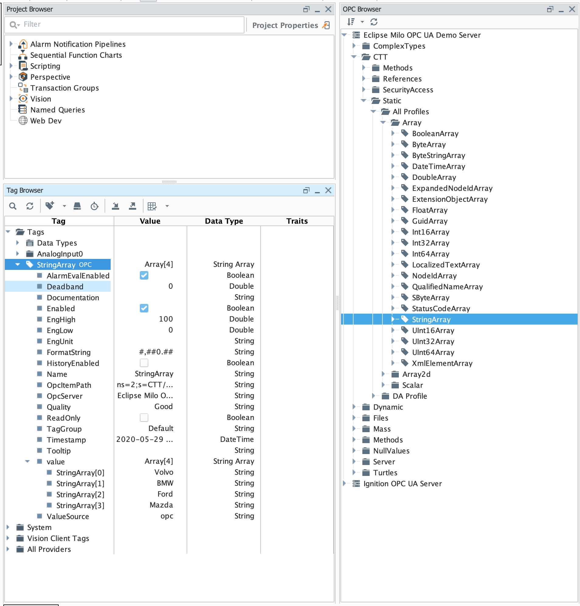

Unless this happens to be fixed by something in 8.0.13 I don’t think it’s fundamentally broken because I can pull in a String array from the public Eclipse Milo Demo Server just fine:
 ![image](https://us1.discourse-cdn.com/inductiveautomation/original/2X/0/0aa895ace1500c55ab0c0ff61d808183264d140b.png)
Can you try connecting to the demo server (`opc.tcp://milo.digitalpetri.com:62541/milo`) and/or the 8.0.13 nightly and let me know if it works?
If it does the issue may be specific to the server you’re connecting to.

Looks like that works, and it must just be that our array is configured incorrectly on the PLC.
We created a tag of data type STRING[10] in studio 5000, is that not the same thing? When we browse it in ignition it shows as a folder of tags, not as a tag
**Post date:** [June 3, 2020, 3:41pm UTC](https://forum.inductiveautomation.com/t/reading-a-opc-ua-array-in-designer/31878/5 "2020-06-03T15:41:32Z")
Not the same thing at all. None\* of our drivers use actual array types, they use folders that contain a tag per element as you see.
Can you turn the loggers OpcUaSubscriptionModel and OpcUaSubscriptionSynchronizer to TRACE and then drag the array tag that doesn’t work from the OPC browser to the tag browser again? Usually Config\_Error means the monitored item couldn’t be created for some reason.
\*new Omron FINS driver does support array types, none of the old ones do.
