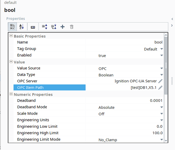

Hi,
In my setup i have the following
Ignition : 8.0.3
Siemens controller : S7-1212C fw 3.0.2 (192.168.13.30)
PC : 192.168.13.40
I have created an array of boolean tags(10) in my data block DB1. The address spans from 4.0 to 5.1. I am able to read/write the tags individually when i create a new opc tag like
dummy1 (address [test]DB1,X4.0)
dummy2 (address [test]DB1,X5.1) etc
but this does not seem to work when i create a **new data type** and use the parameter value to provide the index.
index = 1
new tag (address **[test]DB1,X{index\*0.1+4.0}**)
when I try the above for the tag data, I am receiving data from DB1 address 4.7 instead. The above approach works well for a int and real data array.
Attached is a captured wireshark trace, where i tried changing the Boolean address from 4.1 to 5.1 in Ignition . In the trace the request seems to be for a complete byte instead of a bit.

 ![S7%20DB%20parameters](https://us1.discourse-cdn.com/inductiveautomation/original/2X/2/2507af53627e993544902204781292ca81427657.png) ![ignition_bool_tag](https://us1.discourse-cdn.com/inductiveautomation/original/2X/1/11f7228cdb92b5c6016e2c7fd2404a734b86fce3.png)

> [@smenon6](#):
> index = 1
> new tag (address **[test]DB1,X{index\*0.1+4.0}** )
I'm a little surprised that your UDT works at all. With index = 1 your parameter expression is `(1*0.1+4.0)`. The floating point numbers (0.1 and 4.0) are treated as integer, that result in `(1*0+4)=4` so the final opc address is `[test]DB1,X4`.
To use your parameter as bit address, the parameter expression should be `[test]DB1,X4.{index}`.
If you want to use bit numbers \> 7 with offset X4.0, the expression
`[Test]DB1,X{4+index-index%8}.{index%8}`
should do the trick.
Even when you only want to read a single bit, the driver will always request the full byte.

Thanks for the help. I had to slightly tweak the equation to [Test] DB1, X{4+index/8}.{index%8} this is good for array index starting with 0.

I am facing a slight problem with the above approach. I am expecting {index/8} to give me a integer value, but there is a rounding off happening that is causing some of the tags to be misaligned. For eg when the index is 6/7. Any ways to overcome this
**Post date:** [October 3, 2019, 1:06pm UTC](https://forum.inductiveautomation.com/t/reading-bool-array-from-s7-db/28750/6 "2019-10-03T13:06:06Z")
Try:
```auto
[Test] DB1,X{4+(index-(index%8))/8}.{index%8}

> [@smenon6](#):
> My array in S7 udt is bool[1 to 30]
Ignitions driver uses the legacy S7-300 protocol and knows nothing about the data type definition in the plc. Even a bool[101..130] array would still start at the bit address `DB1.DBX4.0`.
If you want the parameter in Ignition to match your array index in the plc try
```auto
[Test]DB1,X{4+( (index-1) -( (index-1) %8))/8}.{ (index-1) %8}
(i did not test this expression)
