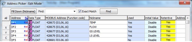

I’m trying to read a couple of analog values from a CLICK plc. I am able to read and write the discrete vales but all analog values I try to read come back as 0. I have tried reading the address 428673 as both Float and Double, as well as Int but it still comes back as 0. Any ideas as to what I am doing wrong

Well, in the setup you posted a picture of you’re reading starting from address 73. Have you tried changing the start address to 28673 instead? Also, stick with Float.

**Post date:** [July 9, 2012, 4:51pm UTC](https://forum.inductiveautomation.com/t/reading-click-modbus-analogs/4789/3 "2012-07-09T16:51:43Z")
Now I am reading data, but the numbers are really big “Value: 5.524223E16”.
**Post date:** [July 9, 2012, 4:55pm UTC](https://forum.inductiveautomation.com/t/reading-click-modbus-analogs/4789/4 "2012-07-09T16:55:07Z")
You may need to play with zero-based addressing setting. It’s in the advanced area, try disabling it.
**Author:** ![Micky.Franks](https://avatars.discourse-cdn.com/v4/letter/m/c57346/32.png) [@Micky.Franks](https://forum.inductiveautomation.com/u/Micky.Franks)\
**Post date:** [July 9, 2012, 5:13pm UTC](https://forum.inductiveautomation.com/t/reading-click-modbus-analogs/4789/5 "2012-07-09T17:13:29Z")
That did it. Any idea as to why I am losing my decimal place even though it’s set at float?
**Post date:** [July 9, 2012, 5:24pm UTC](https://forum.inductiveautomation.com/t/reading-click-modbus-analogs/4789/6 "2012-07-09T17:24:08Z")
Your decimal should be there, but if it’s a 0 it’s not being displayed in the SQLTags browser. If you’re displaying the tag in a component on a window you may need to play with the display format.
