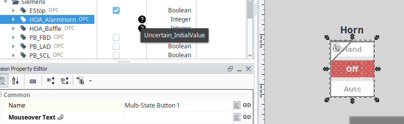

I am trying to read the below tags from PLC:
![image](https://us1.discourse-cdn.com/inductiveautomation/original/2X/c/c8c78c547a7c2875fcc4e935597d4708da7a444b.png)
However, I get the message below:
 ![image](https://us1.discourse-cdn.com/inductiveautomation/original/2X/a/abd31a7e9ef02b5027cefc777ea6f6eedd19486b.png)
Below is the OPC Item Path:
![image](https://us1.discourse-cdn.com/inductiveautomation/original/2X/1/19279d019ec97d0567381a23ba70d13abd4b8e4e.png)
If I have a %MW30 Tag with Int datatype, is the syntax for that tag in Ignition [DeviceName]MI30?
Sorry if this has been asked already.

Sorry to ask the obvious but Did you try [DeviceName]MW30 ?
And you have other tags working so it’s not a connection issue ?
**Author:** ![chi](https://avatars.discourse-cdn.com/v4/letter/c/0ea827/32.png) [@chi](https://forum.inductiveautomation.com/u/chi)\
**Post date:** [April 18, 2020, 5:06pm UTC](https://forum.inductiveautomation.com/t/reading-siemens-int-data-types/34025/3 "2020-04-18T17:06:27Z")
To read the value as a signed Integer MI30 is correct, but MW30 should also be working.
Did you adjust the security settings as described in [this knowledgebase article](https://support.inductiveautomation.com/index.php?/Knowledgebase/Article/View/29/0/connecting-to-siemens-s7-1200-and-s7-1500)?

I have tried [DeviceName]MW30 and the issue is still there. Interesting thing is my boolean tags are working fine.

I adjusted the security settings and the issue is still there. Do you know what else could cause it? Is my syntax wrong?

I figured out what the solution was, there was a trailing space on the OPC Server name
I just deleted space in the OPC Server name:
![image](https://us1.discourse-cdn.com/inductiveautomation/original/2X/2/23e395c73a983939a0041ab4bbfa63566d3ef08e.png)
