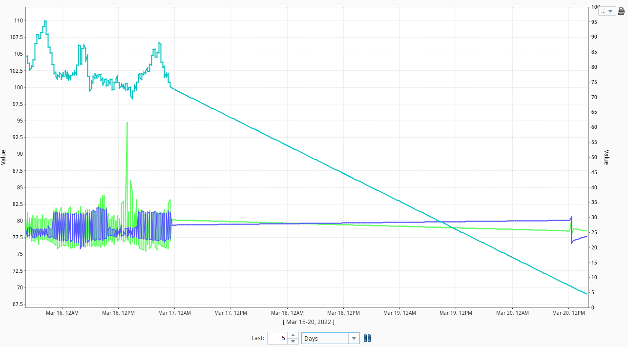

What would cause a real time trend to suddenly start acting in this manner in the middle of the night? I have looked at the settings, audit logs, and tag collection rates and nothing was changed / modified. Any help with this would be greatly appreciated.
 ![image](https://us1.discourse-cdn.com/inductiveautomation/original/3X/7/2/728c741b3ccac317dd51be6925c0b8eee19f28c0.png)
**Post date:** [March 21, 2022, 12:20am UTC](https://forum.inductiveautomation.com/t/real-time-trending/57400/2 "2022-03-21T00:20:48Z")
Full or bogged-down database?
**Author:** ![Nicholas\_Houston](https://sea1.discourse-cdn.com/inductiveautomation/user_avatar/forum.inductiveautomation.com/nicholas_houston/32/68700_2.png) [@Nicholas\_Houston](https://forum.inductiveautomation.com/u/Nicholas_Houston)\
**Post date:** [March 21, 2022, 4:11pm UTC](https://forum.inductiveautomation.com/t/real-time-trending/57400/3 "2022-03-21T16:11:44Z")
That was it, thank you @pturmel
