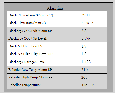

Here’s a little table I setup with labels on a XY coordiante view set to percent, this is how it looks in the Designer:
 ![image](https://us1.discourse-cdn.com/inductiveautomation/original/2X/7/716b4b053998fc9996c650d0c0f44dfb6c817676.png)

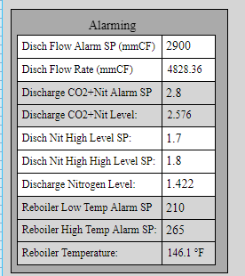

Here’s how the table actually looks on the live web browser:
![image](https://us1.discourse-cdn.com/inductiveautomation/original/2X/c/c6fb88334d220e8a26752b2da50f19bd41807c1f.png)
I don’t see how evenly spaced components become so distorted.
**Post date:** [February 5, 2020, 10:43pm UTC](https://forum.inductiveautomation.com/t/really-frustrating-how-things-fail-to-line-up-in-perspective/31969/2 "2020-02-05T22:43:52Z")
You _really_ shouldn’t be using a coordinate container to try to lay out things like this.
Make a flex-container based view that’ll be the ‘Row’; add two labels, set the left one to `grow: 3`, and the right one to `grow: 1`. Give it two parameters (`label`, `value`) and bind the label’s value to those parameters. Give it a third parameter for background color, if desired.
Then add a flex repeater to your screen. Add as many instances as you have. Add `label` and `value` keys to the instances to set up your individual instances.
In basically no circumstances should you be manually aligning things pixel by pixel in Perspective.
