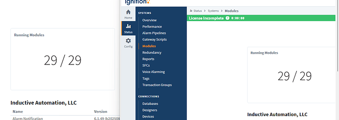

This screenshot is from my backups perspective.
 ![image](https://us1.discourse-cdn.com/inductiveautomation/original/3X/0/b/0b64f8a284edccee19999cb1cb4dfd29e677b5ba.png)
This makes no sense because “Ignition-KYMERASCM\_OTPC1” Isn’t a “backup” it’s the master which shows connected so why is that even there and I cant remove it. From the Masters perspective its the same deal but flipped.
 ![image](https://us1.discourse-cdn.com/inductiveautomation/original/3X/6/d/6de628df5e9fef6df222ad4787c05220bf2930b2.png)
From what I can tell the redundancy is setup and works as I expect but I do not like all these warning signs. Yes both servers are running on the same version with the same 29 modules. I found one other forums post on this and tried to regenerate the metro-keystore file to no avail.
 ![image](https://us1.discourse-cdn.com/inductiveautomation/original/3X/f/2/f2755389f3bd124762fafb52283dfb1c523845ae.png)
 ![image](https://us1.discourse-cdn.com/inductiveautomation/original/3X/9/6/9627fba3f91f552930f95829b1c1c676ed913e35.png)
**Author:** ![bschroeder](https://sea1.discourse-cdn.com/inductiveautomation/user_avatar/forum.inductiveautomation.com/bschroeder/32/13260_2.png) [@bschroeder](https://forum.inductiveautomation.com/u/bschroeder)\
**Post date:** [August 29, 2025, 8:57pm UTC](https://forum.inductiveautomation.com/t/redundancy-setup-defined-neverconnected/110281/2 "2025-08-29T20:57:23Z")
Are you 100% sure that every module is the same and the versions of each module are the same?
**Author:** ![Alex\_Rayburg](https://avatars.discourse-cdn.com/v4/letter/a/ee59a6/32.png) [@Alex\_Rayburg](https://forum.inductiveautomation.com/u/Alex_Rayburg)\
**Post date:** [October 20, 2025, 2:02pm UTC](https://forum.inductiveautomation.com/t/redundancy-setup-defined-neverconnected/110281/3 "2025-10-20T14:02:30Z")
This auto resolved an hour later, I guess it just took a little bit to realize.
