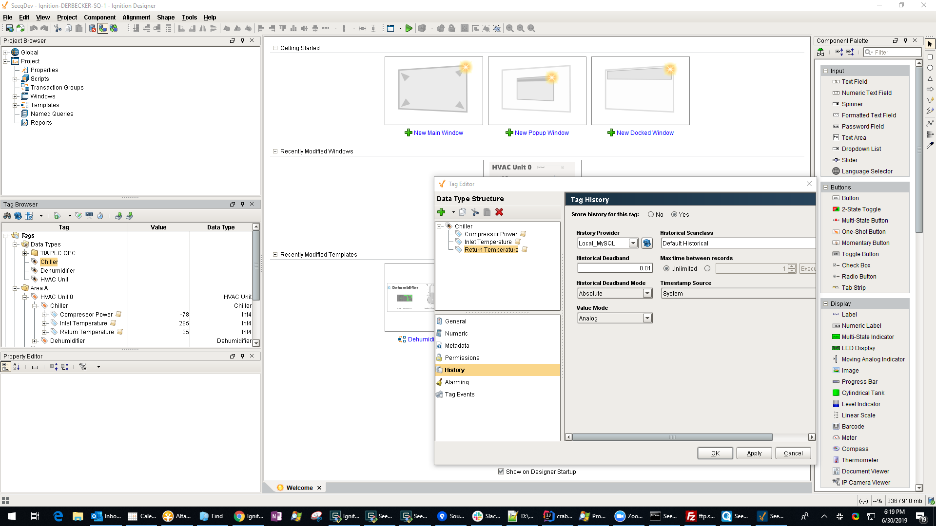

**Author:** ![mpderbec](https://avatars.discourse-cdn.com/v4/letter/m/bbe5ce/32.png) [@mpderbec](https://forum.inductiveautomation.com/u/mpderbec)\
**Post date:** [July 1, 2019, 1:28am UTC](https://forum.inductiveautomation.com/t/refactor-14335-ignition-8-equivalent-of-tagprop-interpolationmode/26183/4 "2019-07-01T01:28:51Z")
@Kevin.Herron I don’t think that’s it. In the Ignition 7 Designer, this property was shown in the UI as **Value Mode** , and there was also a different separate concept called **Historical Deadband Mode**.
So it seems to me that the concept of Value Mode has just been dropped, because you can’t specify it anywhere. Any chance you could confirm that with your development team? It’s an important concept so I’d be surprised if there isn’t an equivalent in Ignition 8.

**Post date:** [July 1, 2019, 3:52pm UTC](https://forum.inductiveautomation.com/t/refactor-14335-ignition-8-equivalent-of-tagprop-interpolationmode/26183/5 "2019-07-01T15:52:11Z")
The `LegacyTagPropUpgrader` specifically upgrades the InterpolationMode prop into `historicalDeadbandStyle`:
```java
        registerPropertyUpgrader(TagProp.InterpolationMode,
            new BasicPropertyUpgrader(
                new BasicProperty<>("historicalDeadbandStyle", InterpolationMode.class, InterpolationMode.Auto)));
Which is now defined in `com.inductiveautomation.gateway.tags.history.actor.TagHistoryProps`, rather than in common tag properties.
**Post date:** [July 1, 2019, 4:01pm UTC](https://forum.inductiveautomation.com/t/refactor-14335-ignition-8-equivalent-of-tagprop-interpolationmode/26183/7 "2019-07-01T16:01:17Z")
@Kevin.Herron I did a face palm as well, I should have clicked on **Deadband Style** to see what its values were.
@paul-griffith, `com.inductiveautomation.gateway.tags.history.actor.TagHistoryProps` does not appear to be accessible in the Ignition SDK. I’ll just do `new BasicProperty<>("historicalDeadbandStyle", InterpolationMode.class, InterpolationMode.Auto)` for now but it might make sense to expose those `TagHistoryProps` in the SDK so that code like mine doesn’t proliferate and make it harder for you guys to control.
**Post date:** [July 1, 2019, 4:10pm UTC](https://forum.inductiveautomation.com/t/refactor-14335-ignition-8-equivalent-of-tagprop-interpolationmode/26183/8 "2019-07-01T16:10:18Z")
I’ll make a ticket, no reason (I can think of) those shouldn’t be available in the SDK.
