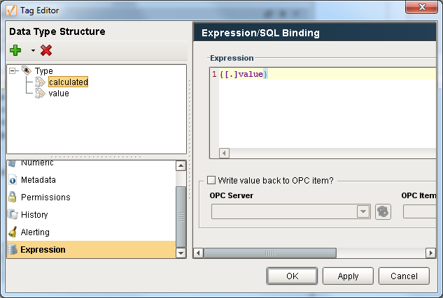

Hello,
i encountered a problem when using DataType’s with a driven ScanClass. On first execution of the ScanClass, Instance tags fail with ‘REFERENCE\_NOT\_FOUND’. Subsequent triggers work as expected.
If Tags are ‘chained’ in the DataType using expressions, there is an additional ScanClass execution necessary to get the second tag working.
Here are some screenshots of a simple project to reproduce the issue, i can also post a backup, if this is helpful.
The tags in the DataType use a driven ScanClass, driven by any change of tag ‘Trigger’.
Ignition version is 7.5.2.
I hope there is an easy solution for this, i need to log data reliable starting from the first trigger.
Thank’s for your help.
![](https://us1.discourse-cdn.com/inductiveautomation/original/2X/e/ef7529d1841c93a481b848fe1857f82f0b9dfbdd.png)
 ![](https://us1.discourse-cdn.com/inductiveautomation/original/2X/7/72d8b03749269261c5c846d2221e38cfa056d510.png)
 ![](https://us1.discourse-cdn.com/inductiveautomation/original/2X/a/adddb4e6fae489edbbbef54204a4b23097678a67.png)
 ![](https://us1.discourse-cdn.com/inductiveautomation/original/2X/3/37e634200d2da6a3fb13c5bf5cd0ffe457a4c77a.png)

Hi,
I’ll have to look into this- as long as everything is in the same scan class, they references should execute each other. The reference\_not\_found quality is the default quality for a reference, until it successfully executes, leading me to believe that for some reason the parent expression thinks the reference is in a different scan class or something, and thus doesn’t execute it. The scan class finally executes it, so the value is available on the next cycle.
I’ll try to mock it up today and see.

Thanks for the backup, we were able to quickly replicate it and track it down. Basically, it goes like this: references were subscribed on first execution of a tag. Depending on how quickly the subscription update was received, and the order of the tag execution, it sometimes might be lined up for the first exec, otherwise it would come through on the next one.
We’ve fixed it so that the tag reference is always in place (assuming the tag exists) for the first execution, and that the order of the execution doesn’t matter, because if they’re in the same scan class, the referencing tag will first cause the referenced tag to execute.
This will be available in the first 7.5.4 beta.
