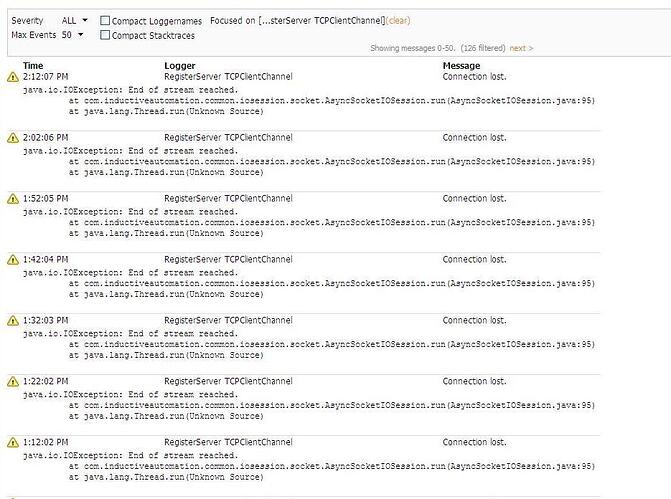

Ignition 7.5.4 on Windows Server Enterprise 2007 on VM Server with 4 GB Ram
Running a ton of SQL Queries to populate data displays and reports but no significant CPU usage. SQL DB on both the local machine and the SQL Plant DB on a remote machine. Memory is utilized close to 4 GB. OS and Memory upgrade scheduled later this spring.
All IO comes from OPC DA from KepWare 5.5 on the local machine. 0% Problems with KepWare.
Ignition running well for 1.5 years but occasional performance problems.
I am studying the console to find issues and errors. I am getting a repeating warning every 10 minutes: “RegisterServer TCPClientChannel Connection Lost”
Screen Shot attached. What is this warning and how do I correct it?
Thanks Ken P.
 ![](https://us1.discourse-cdn.com/inductiveautomation/original/2X/6/674cdd40a859f1999ef0d4d0f92a9453ede7bec2.JPG)
**Post date:** [February 1, 2013, 12:18am UTC](https://forum.inductiveautomation.com/t/registerserver-tcpclientchannel-connection-lost/5779/2 "2013-02-01T00:18:04Z")
Go to the UA settings and set the discovery registration frequency to 0 and disable the discovery server.
