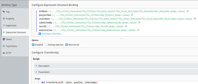

Whenever I want a binding update to trigger when any number of values are changed, like in this table data filtering example, I use an Expression Structure Binding.
 ![image](https://us1.discourse-cdn.com/inductiveautomation/original/3X/5/d/5d259fd17ba0540c61fe5ea4bbd6db63c3c17c8c.png)
This ensures that any time any one of those filters (`endDate`, `projectNum`, etc.) update, the table data refreshes.
