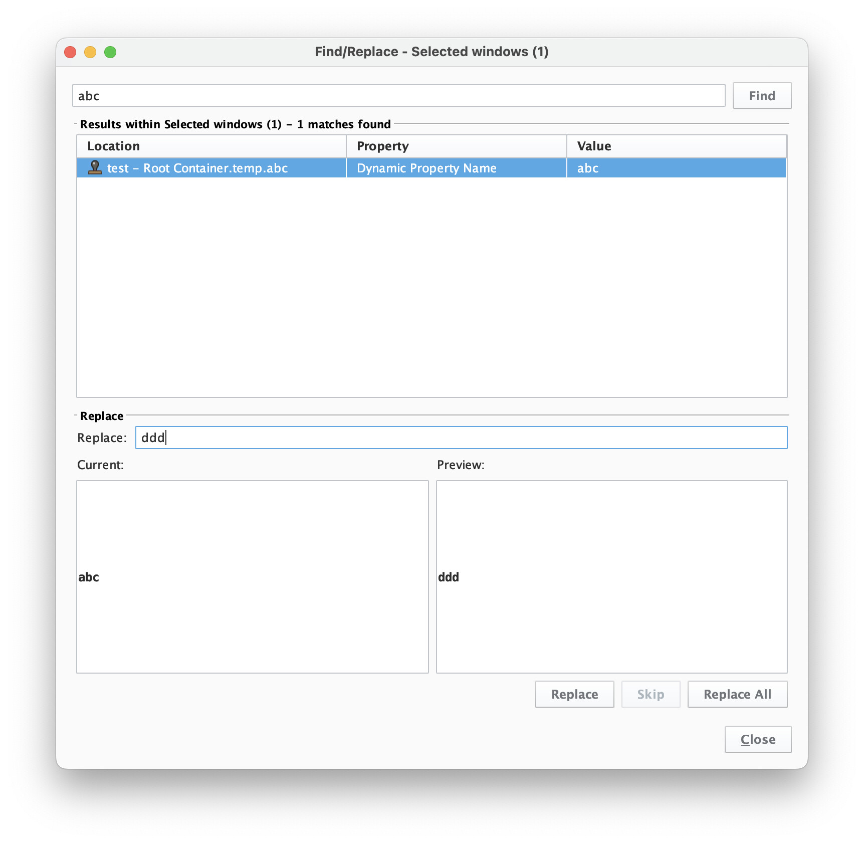

**Post date:** [August 20, 2025, 5:47pm UTC](https://forum.inductiveautomation.com/t/renaming-vision-template-parameters-removes-corresponding-template-instance-parameter-values/109951/23 "2025-08-20T17:47:07Z")
So you might get somewhere with [`DynamicPropertyProviderCustomizer.renameProperty`](https://files.inductiveautomation.com/sdk/javadoc/ignition81/8.1.49/com/inductiveautomation/factorypmi/designer/property/customizers/DynamicPropertyProviderCustomizer.html#renameProperty(java.awt.Component,java.lang.String,java.lang.String)) (note that this is a static method).
Interestingly, it actually looks like find & replace is supposed to work for this:
 ![Screenshot 2025-08-20 at 10.44.20 AM](https://us1.discourse-cdn.com/inductiveautomation/original/3X/9/a/9a1fc799dd5270bfbf61138a1f866a4fd0b6be3a.jpeg)
But an internal bug in the find and replace code (probably because templates are special unicorns) means that it fails:

But an NPE is a bug I can fix, so I can put this on the agenda to fix in some future \>= 8.3.x release.
EDIT: This is IGN-14005 if you want to contact support about it and have them tell you when it's fixed.
