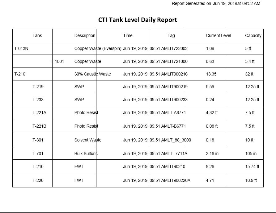

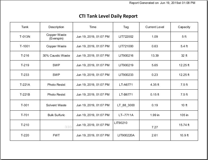

I have an issue where the tables I set up in a report are not being output to a PDF the way they should be. All of the cell text and values are supposed to be aligned to the center in this report, but first character ends up being centered when the report is emailed. I have attached pictures. The properly formatted report is the one generated in the preview screen. The improperly formatted report is the actual report delivered to my email inbox.

Got the same problem with 7.9.3
Avoided temporary changing front to Arial Narrow
Problem has been fixed starting from 7.9.8
