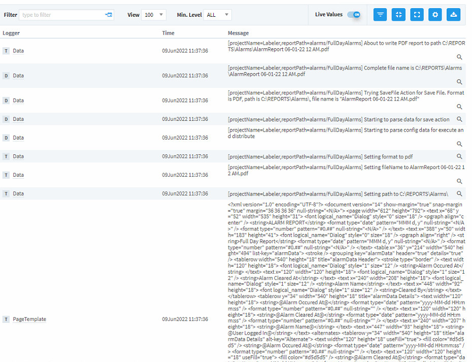

I have a report that I want to save and I am not getting any errors but things do not seem to be saving either.
In the gateway logs, I set everything related to Reporting to `Trace`. No error appears. I just see that its about to write the PDF and stops -
 ![image](https://us1.discourse-cdn.com/inductiveautomation/original/3X/e/c/ec4bd7f9a994bbec15c4fa098b91c417bb27c523.jpeg)
Last log
```auto
[projectName=Labeler,reportPath=alarms/FullDayAlarms] About to write PDF report to path C:\REPORTS\Alarms\AlarmReport 06-01-22 12 AM.pdf
But no error appears and no report appears in that location so I am at a loss. Any ideas what is going wrong?

Maybe a dumb question, but are you looking for the file on the gateway? `executeAndDistribute` would save to the gateway not the client I believe.

Sometimes the dumb questions are the right one…lol.
