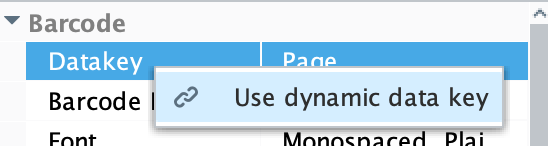

I set the Datakey of barcode to the built in datakey “Page”. However, the barcode shows the text “Page” instead of numerical page number 1,2,3….
I did the same for a textshape on top of the barcode, and it works.
Appreciate any help!

On the Properties tab, use dynamic key on the Datakey property:
 ![image](https://us1.discourse-cdn.com/inductiveautomation/original/3X/9/b/9b680e55df165573b3da99473e0d7d7f188aea59.png)
Right click to bring up the context menu. Then “Page” should now work.

![{EE8187A2-46EE-4A0B-A75F-ECB44A5BABFC}](https://us1.discourse-cdn.com/inductiveautomation/original/3X/6/d/6da78b13c38c03bda70ca1ddfa76158f75e3f2c2.png)
Changed as suggested. but the barcode still displays the text “Page”

After changing the Datakey to a dynamic key try using the Key Browser (in the Properties tab) to select the built in `Page` key.
 ![image](https://us1.discourse-cdn.com/inductiveautomation/original/3X/6/a/6a46f37c5f42e362dfd965c418f485d130056046.png)
If I change the Datakey to to a dynamic key and test, it does show the text “Page”. Once I updated the Datakey field with Page, I see the page number.

In 8.1 `Built In` keys did not work with dynamic key Bindings. So if you’re using 8.1 then this might be the reason it’s not working for you.
