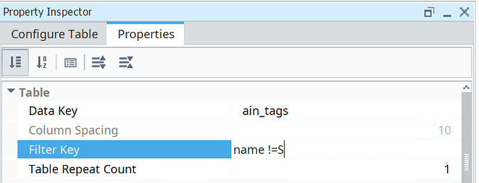

Hello,
is there a way to filter out duplicate entries in the perspective report using the filter key property? what would be the expression code if the column name is 'name'
 ![image](https://us1.discourse-cdn.com/inductiveautomation/original/3X/d/2/d2cafb1003882eb656a81cd8a28a13e01d4dd51a.png)
**Post date:** [July 29, 2024, 7:44pm UTC](https://forum.inductiveautomation.com/t/report-table-filter-key/93865/2 "2024-07-29T19:44:21Z")
That filter only works **within** a row, not across rows. Perhaps with grouping. But I suspect you need to filter these out in your SQL.
