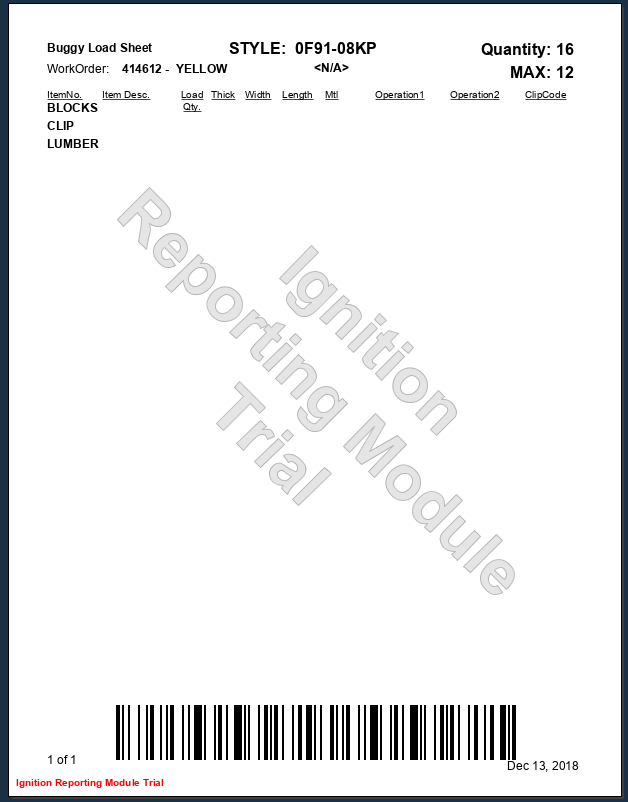

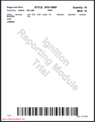

I have a report viewer that displays a report that runs several queries to fill it with data. The report works normally in the designer, and it works fine in the client when signed in as the admin. When I log into the project as another user profile the report shows up without any overlays, but the report is empty. I have legacy database access enabled, but I’m not sure what else is blocking the report from actually running.
 ![](https://us1.discourse-cdn.com/inductiveautomation/original/2X/d/d15c1a1717b9ace5c72ac745c00d66f7e15f0a43.png)
 ![](https://us1.discourse-cdn.com/inductiveautomation/original/2X/a/aa77f629899f0b5c118fdc0f5e37412ed340dbf5.png)
**Author:** ![dkhayes117](https://sea1.discourse-cdn.com/inductiveautomation/user_avatar/forum.inductiveautomation.com/dkhayes117/32/68344_2.png) [@dkhayes117](https://forum.inductiveautomation.com/u/dkhayes117)\
**Post date:** [December 14, 2018, 1:51pm UTC](https://forum.inductiveautomation.com/t/report-viewer-shows-empty-report-in-client/21414/2 "2018-12-14T13:51:09Z")
Solved: There was a typo in the scripting on one of the report parameters that was user specific.
