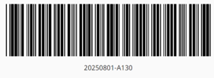

Hi, I'm using a barcode component in the reporting module. I have it set to code 39, and I am appending asterisks to the beginning and end of the string that I use as the data key for the component, but it won't scan using multiple scanners.
To test the barcode, I also tried using a Perspective barcode component also set to code 39 and the resulting barcode is pretty different from the reporting module's barcode.
Here's the code 39 barcode generated by the reporting module:
 ![{46B55ECD-0E61-450A-8185-1FB7C33C4352}](https://us1.discourse-cdn.com/inductiveautomation/original/3X/0/8/0804ebfa0eb26a95bef413ffa9ce002b8ed851a2.png)
And here's the code 39 barcode generated by the Perspective barcode component:
 ![{511EE65C-FE8E-4EF0-9C41-08355A461812}](https://us1.discourse-cdn.com/inductiveautomation/original/3X/1/f/1f86fbbafa2082ef783275a96d2b4a78c8fbb4ae.png)
Is there a setting or something that I'm missing?

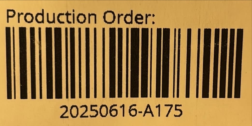

I also noticed that our customer's barcode includes the asterisks in the raw barcode data.
Here's the customer's barcode:
 ![image](https://us1.discourse-cdn.com/inductiveautomation/original/3X/6/f/6fee081d017beafeffa6a297a04f3396f3f92662.jpeg)

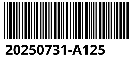

And here's one from the reporting module that was printed off (different data, but same length):
 ![image](https://us1.discourse-cdn.com/inductiveautomation/original/3X/b/f/bfed820af00e9ff3b104e3647dd4ff93d4fa5d1e.jpeg)

I found the name of the font that the client's old system uses, the IDAutomation Code 39 font. I printed off the same information using this font, a Perspective barcode, a Reporting module barcode, and a Vision module barcode.
All of them worked except for the Reporting module's barcode component. This is what they look like:
IDAutomation Barcode Font:
 ![{1330073D-5158-451E-B0A3-67A191AE7F53}](https://us1.discourse-cdn.com/inductiveautomation/original/3X/c/e/ce1496aa35301648bc50da927b26131b6783ec1f.png)
Perspective:
 ![image](https://us1.discourse-cdn.com/inductiveautomation/original/3X/e/8/e8217d69cc88c8181ef87837cd7c66e65db06833.png)
Reporting:
 ![image](https://us1.discourse-cdn.com/inductiveautomation/original/3X/c/5/c54180ccfa3c05dfd9d206df0cae381c31d03ae6.png)
Vision:
 ![image](https://us1.discourse-cdn.com/inductiveautomation/original/3X/7/8/78e3596aa5a6736236e04e6635e0143cf9b02538.png)
Something doesn't seem right to me, because all of them scan except the one generated by a report.

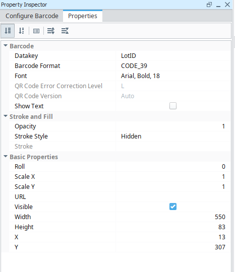

We use Code\_39 barcodes on thousands of labels a day across dozens of Zebra printers.
We do NOT include the asterisk on the data source for the label, and we have no problems with scanning the values?
I don't think the font choice really affects it but ours are set to Arial, 18 Bold
Screenshot of the controls settings.
LotID is a 17 digit string passed as a parameter to the report.
Could it be a scaling issue with the label size and margins?
Is your report set to the exact size of the actual label with margins accounted for?
 ![image](https://us1.discourse-cdn.com/inductiveautomation/original/3X/3/a/3a6b97d4908441488e8db07a37f9b2daa1e67edc.png)
