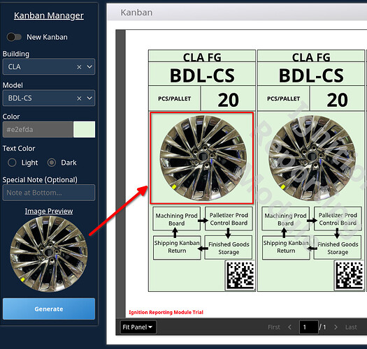

I have a perspective application that contains a report. I am embedding images into this report and the perspective view from an azure blob storage container using a shared access signature.

**The Problem:**
The perspective image component works perfectly and renders the image every time. However, in the reporting module image component, I am only able to render the image **some of the time**. Turns out that the times the image won’t render in the report image component, there is a %2B in the URL, which is the URL\_encoded “+” character.
 ![image](https://us1.discourse-cdn.com/inductiveautomation/original/3X/d/8/d8865abfcf6d691aa94f9d3864ceeb7996432b87.png)
The url’s without that character render fine in both the perspective image component and the report image component. Is this expected behavior?
 ![image](https://us1.discourse-cdn.com/inductiveautomation/original/3X/0/2/024d1786fecf7e07504e9a72e3d1f91bb782dbcb.jpeg)
**Post date:** [October 20, 2025, 7:08pm UTC](https://forum.inductiveautomation.com/t/reporting-module-2b-url-encoded-character-is-not-recognized-by-the-image-component-bug-or-operator-error/111604/2 "2025-10-20T19:08:37Z")
Sounds like a bug. You should open a support ticket.
