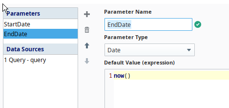

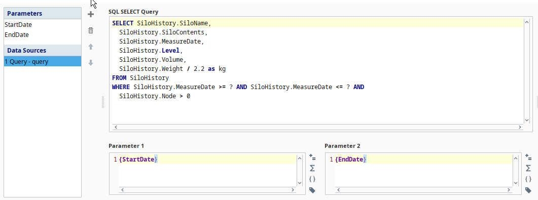

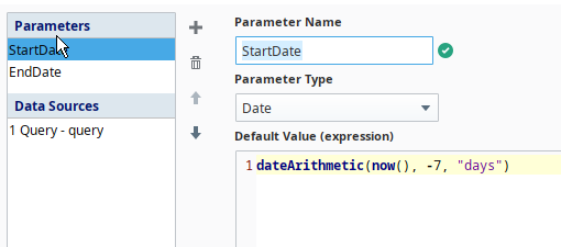

**Post date:** [May 9, 2022, 2:04pm UTC](https://forum.inductiveautomation.com/t/reporting-module-date-data-type/59333/5 "2022-05-09T14:04:12Z")
You should probably parameterize theses. An example Note the question marks in the query, with the parateres at the bottom of the :
 ![image](https://us1.discourse-cdn.com/inductiveautomation/original/3X/0/3/03aafddab88c24bc58bc974e068b0413df5c4666.png)
 ![image](https://us1.discourse-cdn.com/inductiveautomation/original/3X/1/d/1da9a05bf95faa0472fc6dc57bb9f5e3a4b6884a.png)
 ![image](https://us1.discourse-cdn.com/inductiveautomation/original/3X/8/0/80c59e326dc49fd93f7b75d753aad4c760b94159.png)
**Author:** ![Neil\_Carty](https://avatars.discourse-cdn.com/v4/letter/n/90ced4/32.png) [@Neil\_Carty](https://forum.inductiveautomation.com/u/Neil_Carty)\
**Post date:** [May 9, 2022, 2:51pm UTC](https://forum.inductiveautomation.com/t/reporting-module-date-data-type/59333/6 "2022-05-09T14:51:50Z")
That did it!! Thank you very much Jordan.
