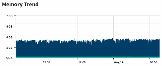

We went from 8.0.11 to maybe 13, then on 8.0.15 RC1 (due to an emergency fix) yet not on the stable, but sometime after 8.0.11, we have a fully scripted report that generates 3 pdfs and 3 cvs documents that get emailed. We run the report manually, so nothing scheduled. The report uses system.tag.queryTagHistory with the Average and Maximum aggregates to generate most of its data, with 100 pages total with about 30 rows each page. This used to take around 6 minutes, but now is taking more than 4 hours. Does anyone know what may have changed? Thanks

**Author:** ![rpavlicek](https://sea1.discourse-cdn.com/inductiveautomation/user_avatar/forum.inductiveautomation.com/rpavlicek/32/55868_2.png) [@rpavlicek](https://forum.inductiveautomation.com/u/rpavlicek)\
**Post date:** [August 14, 2020, 1:46pm UTC](https://forum.inductiveautomation.com/t/reports-after-8-0-11-or-later-taking-a-long-time-to-email-pdfs/37703/3 "2020-08-14T13:46:13Z")
I troubleshooted this last night by manually running the report again with turning on the MDC key method. As I watched, the logs on the gateway status page were flipping through hundreds of thousands of entries, rewriting itself over and over (with times of turning live values off to pause the screen). I tried to watch for patterns, but saw a lot of queries of what it seemed it needed. It got late when the report finished, so I was only able to look at the logs in the morning, but only show the last timeframe of entries and can’t see what might be going on there.
As far as memory, here’s the gateway cpu and memory snippets below. Notice the cpu spike showing the timeframe when the report was running and match to the memory chart, both seems normal there. So maybe the database server?
 ![image](https://us1.discourse-cdn.com/inductiveautomation/original/3X/0/0/007b4eb8bfad048f337da704cce5c139dfe2c32f.png)
 ![image](https://us1.discourse-cdn.com/inductiveautomation/original/3X/2/9/29b913c8ff9c22440e6b02fe034cf32e71adc023.png)

We finally were able to fix this, it goes back to what we suspected it was which I will describe below. On a side note, pturmel’s later.py came in handy. Another issue going back before this which was a known bug, was the length of time to generate xlsx files. It took many hours and was due to how the report handled formatting each cell exponentially increasing the time. While this was fixed in recent versions, if we ran the report as we had it originally, our xlsx would be blank, but pdf’s would be fine. By using the later.py callAsynch, it generates everything in full. (Is this a thread/memory/race condition issue?)
Anyways, a few months back, after our tag structure wouldn’t save any changes or new tags, we created a new tag provider, exported most tags over renamed them so the new was the same name as the default. What this did was create a lot of duplicate tagid entries in the sqlth\_te table without retiring the old, along with the associated entries in the scinfo and drv tables. We even created tickets on this with support before doing this with no resolution as well as noting this in our recent ticket on our report length issue. So what I did was a few queries to delete all of these extra entries out. I also looked and saw that only a 10-20 minute windows of time used these new tagids during the renaming process above, so we didn’t care to update the tagids in the data partition table affected (can always later).
