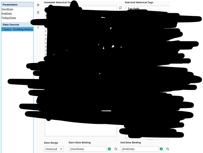

I am having a problem with my reports.
I currently have a series of VFD’s and their associated interlocks historized and mapped to a series of timeseries charts. In the designer and preview they seem to be working properly, but I have a schedule to send to an email address and when they arrive, the date range is wrong.
Here is what i have set for my start date/end date/history date setup
 ![image](https://us1.discourse-cdn.com/inductiveautomation/original/3X/9/5/95aa78bcfc43c8103dcac9bc45bc19f588ed6368.png)
 ![image](https://us1.discourse-cdn.com/inductiveautomation/original/3X/3/e/3e72698cf81c04c0c639dd465bfaae415df0e0a0.png)
 ![image](https://us1.discourse-cdn.com/inductiveautomation/original/3X/9/3/9325d32742f78375e553407ffef3c296fbead1c4.png)

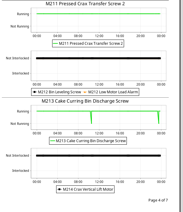

here is what the page looks like in preview (what i want it to look like)
 ![image](https://us1.discourse-cdn.com/inductiveautomation/original/3X/a/c/ac69fc52886b1e85eaae1fa4e0984439b16592a7.png)
Here is what it looks like when it is received as a pdf via email
 ![image](https://us1.discourse-cdn.com/inductiveautomation/original/3X/7/0/700bb6d644e65bd8d5e859fc03cac0b8de5323a9.png)
Instead of the timespan being 24 hr for the previous day, it is the last 3 days. i am not sure what is causing this or why it is different between the preview and pdf.
any help is appreciated, thanks.

just a quick comment on your start date expression. It seems like you’re trying to get midnight of the previous day. A cleaner way to do that would be
`midnight(dateArithmetic(now(), -1, “day”))`
For your end date you can do
`dateArithmetic(midnight(now()), -1, “second”)`
**Author:** ![Alex\_Jaffe](https://avatars.discourse-cdn.com/v4/letter/a/ecccb3/32.png) [@Alex\_Jaffe](https://forum.inductiveautomation.com/u/Alex_Jaffe)\
**Post date:** [September 17, 2025, 2:23pm UTC](https://forum.inductiveautomation.com/t/reports-historian-query-timeseries-charts-not-displaying-the-correct-date-ranges/110714/4 "2025-09-17T14:23:08Z")
didn’t realize there was a midnight function, thank you, that will help simplify things
