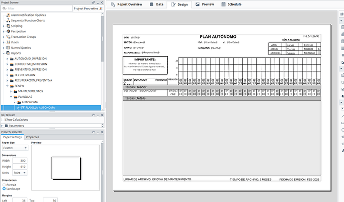

Hi, I have this in my Ignition web page .py but I have a problem so, I want to show this report

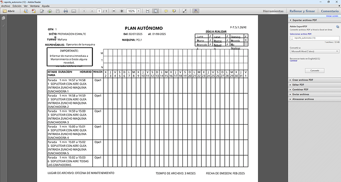

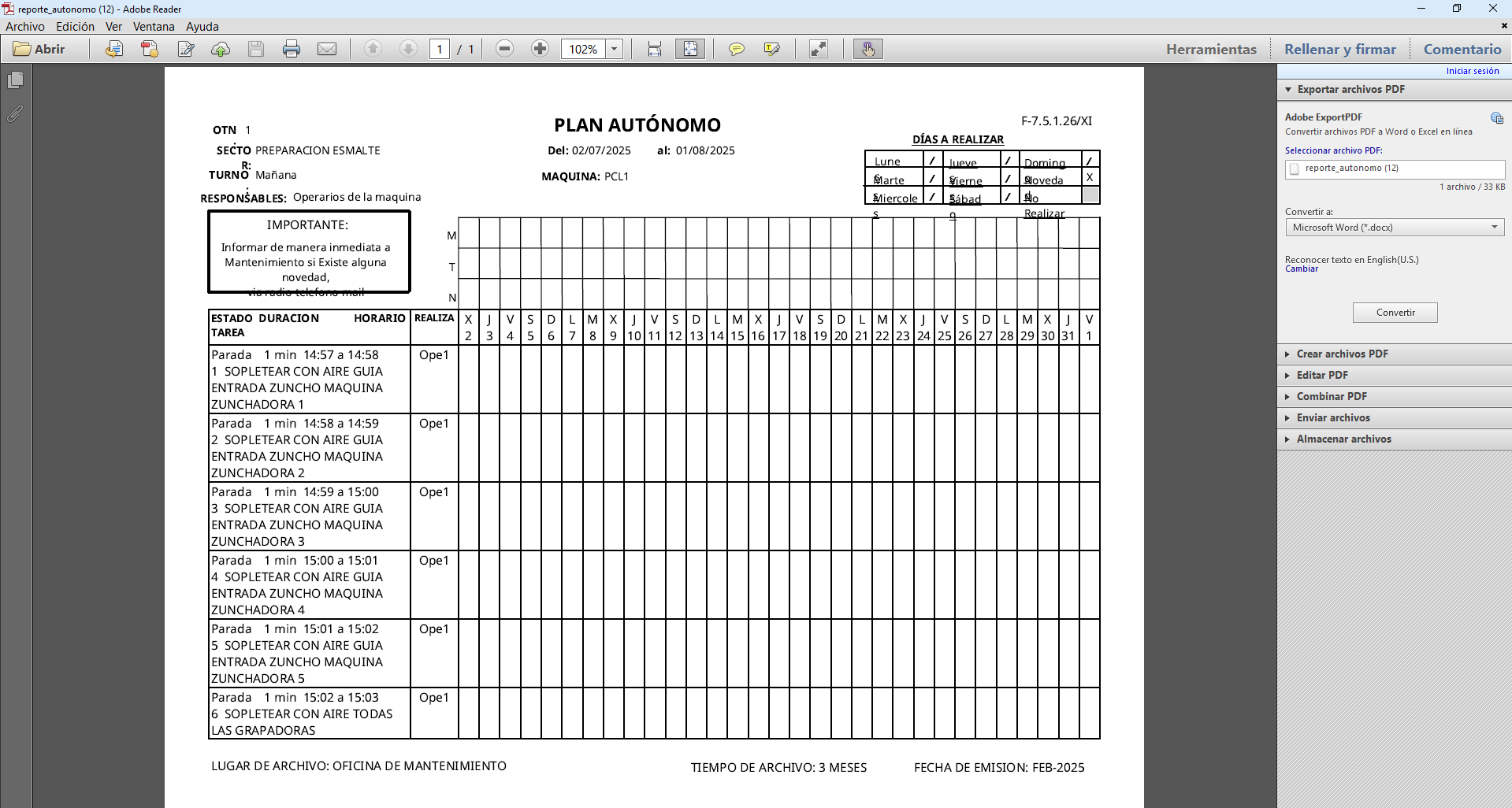

 ![image](https://us1.discourse-cdn.com/inductiveautomation/original/3X/e/f/ef13fc09539a1daaa691ce6dda0ac7b5eacf29e6.png)
And not download such as pdf when I open with adobe it show very very disconfigured.
 ![image](https://us1.discourse-cdn.com/inductiveautomation/original/3X/e/7/e74e4e16f32088f1b4ffb095c81a5c917a517a00.png)
Please help me to show in the web without download it
