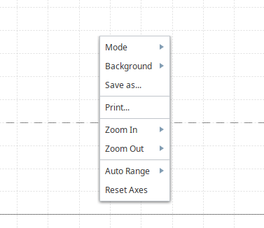

Hi,
I am using Classic chart in vision. In chart if we right click we have option for **Reset Axes**
Is there any way to call the Reset axes in script?
 ![resetaxis](https://us1.discourse-cdn.com/inductiveautomation/original/3X/7/b/7b0053d43bb8f545255f4961e02a0c58e50f90b6.png)
Can any one help me out in this?
**Post date:** [November 1, 2021, 4:53pm UTC](https://forum.inductiveautomation.com/t/reset-axes-in-xy-classic-chart/52560/2 "2021-11-01T16:53:02Z")
From scripting, just call `referenceToChartComponent.createChart()`; that’s all the implementation of ‘reset axes’ actually does for the classic chart.
