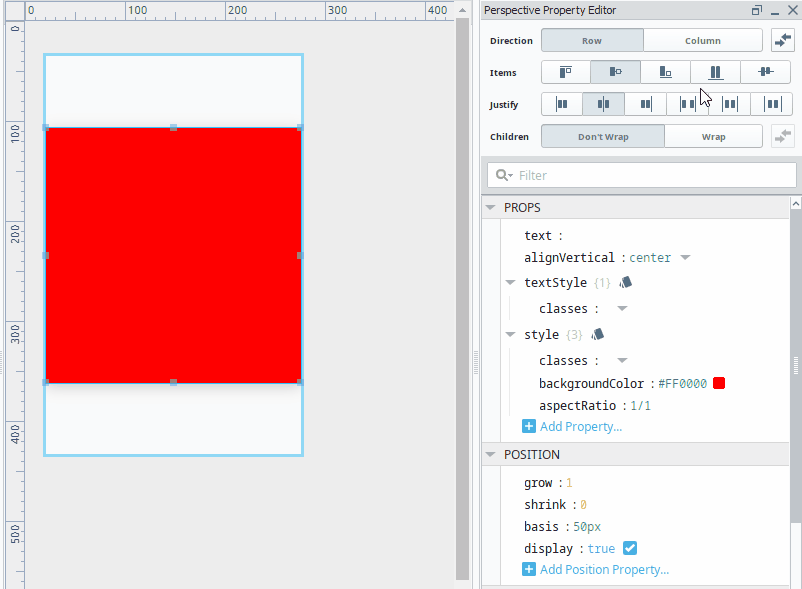

I’m trying to create a responsive square that will automatically resize to fit the size of its container.
I’ve tried using `aspectRatio: 1/1`, but whenever I set any width/height/maxWidth/maxHeight styles it seems to either overwrite the aspect ratio or fail to constrain in one direction. Either it constrains vertically and overflows on the horizontal when the parent’s width becomes less than its height, or vice-versa for the horizontal.
Is there a set of properties that will make this work as intended? And if not, is there a workaround?

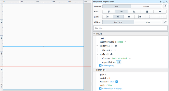

**Author:** ![david.abrahams](https://avatars.discourse-cdn.com/v4/letter/d/e68b1a/32.png) [@david.abrahams](https://forum.inductiveautomation.com/u/david.abrahams)\
**Post date:** [October 2, 2025, 8:51am UTC](https://forum.inductiveautomation.com/t/responsive-square-not-being-fully-constrained-by-parent-container/111152/3 "2025-10-02T08:51:12Z")
I’ve been using 1/1 or 1 throughout the project and it’s been working fine. I’ve just tried 1:1 and it doesn’t appear to work.

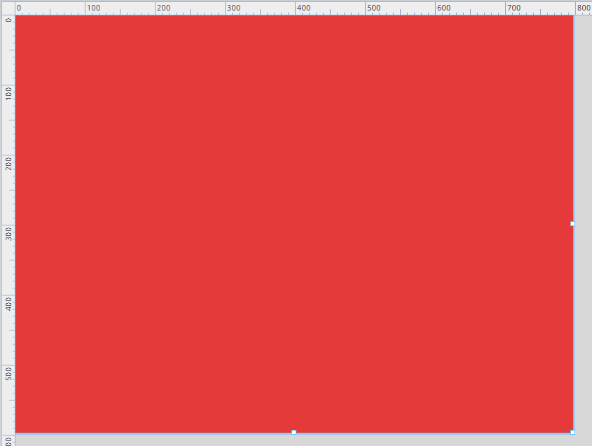

**Post date:** [October 2, 2025, 12:47pm UTC](https://forum.inductiveautomation.com/t/responsive-square-not-being-fully-constrained-by-parent-container/111152/6 "2025-10-02T12:47:26Z")
You have the alignItems set to center, you need to set it to strech. You actually don't need the aspectRatio style. Setting it to strech will make it fill the entire height, the grow setting of 1 will make it so that it always fills the width. I've used the aspectRatio here just to duplicate your example.
![animation](https://us1.discourse-cdn.com/inductiveautomation/original/3X/e/4/e45c827844cbcc19812ba7d8c2691b3d01cb82b6.gif)

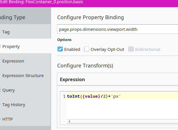

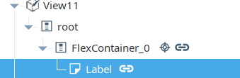

**Post date:** [October 3, 2025, 12:36am UTC](https://forum.inductiveautomation.com/t/responsive-square-not-being-fully-constrained-by-parent-container/111152/11 "2025-10-03T00:36:32Z")
Better version. The 1st wasn’t really responsive in the browser. It just maintained size. This one actually adjusts. It’s setup to be 50% of the width of the viewport.
Structure:
 ![image](https://us1.discourse-cdn.com/inductiveautomation/original/3X/6/3/637ba0e02b135d57de70a9b644ccc5fb0a0276cd.png)
On the Flex Container, bind it’s position.basis like so, with a grow/shrink of 0/0.
 ![image](https://us1.discourse-cdn.com/inductiveautomation/original/3X/a/c/ac00bc4cf34eaf484b3c90d7d5878c1f460f1b34.png)
You can also use this expression instead, so it responds to both height and width of the window:
`toInt(min({page.props.dimensions.viewport.width},{page.props.dimensions.viewport.height})/2)+'px'`
