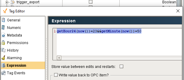

If you want a script to be executed at a specific time every day, the best option for me, is to use an expression tag which should be a boolean set to True depending on your conditions. Then create a Tag Change Gateway Event Script and when your boolean becomes True, your script will execute.
For example, I created an expression tag I named trigger\_export. Here is the expression used :
 ![image](https://us1.discourse-cdn.com/inductiveautomation/original/2X/c/cee1513d65478dc87b24d23583907a1756a6553e.png)

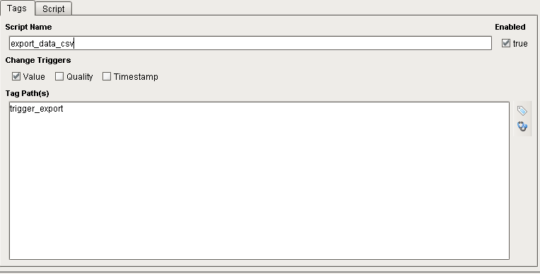

Then i created a Tag Change Gateway Event Script :
 ![image](https://us1.discourse-cdn.com/inductiveautomation/original/2X/3/3820e136a8aac5226a6a5ae485c664d620651c60.png)
```auto
if newValue.value ==1 and initialChange==0: #If tag becomes True
	results = system.db.runQuery("SELECT * FROM example1 LIMIT 100")
	results = system.dataset.toDataSet(results)
	csv = system.dataset.toCSV(dataset = results, showHeaders = True, forExport = False)
	filePath = "C:\\output\\results.csv"
	system.file.writeFile(filePath, csv)
Check out this link for more info about the function to export to csv : [system.dataset.toCSV - Ignition User Manual 8.0 - Ignition Documentation](https://docs.inductiveautomation.com/display/DOC80/system.dataset.toCSV)
