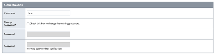

I am looking for a way of retrieving authentication information for OPC connections I have configured
 ![image](https://us1.discourse-cdn.com/inductiveautomation/original/3X/a/2/a242568d35fefd90256b127a637d28a6261f7154.png)
Is there somewhere I could recover the password for an OPC connection I have configured ?
Thank you in advance for your help !

Do you need to do this one time or regularly as part of a script?

It would be a one time thing !
**Post date:** [August 5, 2025, 12:15pm UTC](https://forum.inductiveautomation.com/t/retrieve-passwords-stored-for-opc-connections/109372/4 "2025-08-05T12:15:22Z")
Well the easiest thing would be to use Kindling or any other SQLite DB viewer to open the config.idb file and look at the passwords in the "OpcUaConnectionSettings" table. The password should be stored as a string of hex encoded characters.

It was exactly what I was looking for, thank you very much Kevin !
