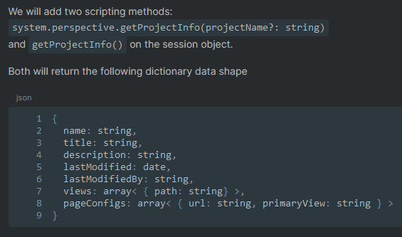

I want to automatically build my Perspective project MenuTree based of the project Page Configuration using a script. Is there any way to access the Perspective project page configuration via scripting?

In 8.1.4 (releasing soon) you’ll be able to access project metadata two ways:
 ![image](https://us1.discourse-cdn.com/inductiveautomation/original/3X/7/8/78b8eff600ba437648ea44549639905212c62622.png)
