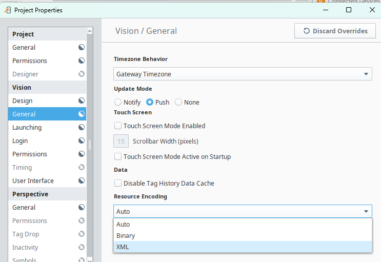

**Author:** ![mauricio\_caceres](https://avatars.discourse-cdn.com/v4/letter/m/8baadc/32.png) [@mauricio\_caceres](https://forum.inductiveautomation.com/u/mauricio_caceres)\
**Post date:** [July 7, 2025, 9:17pm UTC](https://forum.inductiveautomation.com/t/retrieving-all-tag-references-from-a-vision-window/107856/9 "2025-07-07T21:17:23Z")
> [@nminchin](#):
> that your Vision Project Properties are set to save Vision resources as XML and not binary (and if it _was_ binary, save all of your Windows, or at least the ones you want to extract tags from)
Hi there!
I'm looking for to do exactly what you mention in the second paragraph of the comment.
It is really possible to ensure that Vision Project Properties are set to save Vision Resources as XML and not binary?
Could you please elaborate a bit about this topic. I really would like to explore this possibility.
Regards!
**Post date:** [July 8, 2025, 1:37am UTC](https://forum.inductiveautomation.com/t/retrieving-all-tag-references-from-a-vision-window/107856/10 "2025-07-08T01:37:25Z")
![image](https://us1.discourse-cdn.com/inductiveautomation/original/3X/9/d/9d0cfbf6f29b26ef6193db7b021f708c99d0db99.png)
Auto = Binary. Not sure why there is an Auto to be honest...
**Post date:** [July 21, 2025, 4:52pm UTC](https://forum.inductiveautomation.com/t/retrieving-all-tag-references-from-a-vision-window/107856/11 "2025-07-21T16:52:27Z")
Auto reserves us the right to change the default at some point in the future, or come up with an additional (i.e. more efficient/more human readable) encoding.
> [@Porter\_Ellis](#):
> Has Inductive ever considered a 'refactor tag name' functionality based on this tool?
Yes, that's the nature followup idea to the tag reference tracker. It's definitely something we've talked about, but there aren't currently any concrete plans to implement it nor a timeline to do so.
