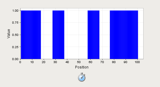

Design question - We would like to track parts through a particular portion of a process. All we want is to graphically illustrate (like on a chart) where the parts are in this one portion of the process (since the parts are obscured from view as they travel through this portion).
What we have tried so far is setting up a transaction group with three columns - t\_stamp, part\_bit (triggered and enters a 1 when a part enters the machine), and part\_track\_ndx. Everything is tracking and logging correctly, but the problem comes in when we go to graphically represent the position of the parts. Only 1500 parts fit in the machine, so we only want to display the last 1500 triggers (note - a trigger will log either a 1 for a part, or a 0 for a gap). On the charts we seem to only be able to represent parts via the t-stamp or ndx column.
Question (finally) - Is there a way to limit the number or DB records to 1500, and to have it work in a FIFO fashion? i.e. update the first record, have all others index back one, then drop the 1501st record? Any help or alternative ideas are greatly appreciated.

Wow! A lot to digest here…
 ![](https://us1.discourse-cdn.com/inductiveautomation/original/1X/8f903aa9c8b6fcc5103102107e77d8a3437f0e8b.png)
My example does it for 100 samples, but you can easily change it to the 1500 you require… 😉
The other caveat is that this uses MySQL. Syntax will differ slightly for other platforms.
The top priority would be to display the data as you want it. The XY Chart will work best for us because we can make the X-axis however we want. But first we want to get the data by rank. I stuck a timer into the container and used this script in the propertyChange Event:
```auto
query="SELECT Ramp FROM FIFO1 order by t_stamp desc limit 100"
table1 = system.db.runQuery(query,"MySQL")
headers = ["Rank","Value"]
i=0
rows=[]
for row in table1:
	i += 1
	newrow=[i,row[0]]
	rows.append(newrow)
event.source.parent.getComponent('Chart').Data=system.dataset.toDataSet(headers, rows)
This gets the data into the XY-chart as rank (1-100) and value (0/1).
Opening the Chart Customizer, we now need a new Number Axis type for the X-Axis:
 ![](https://us1.discourse-cdn.com/inductiveautomation/original/1X/425055d3c76d7158c92c04ef399349835791959e.png)
In the Dataset Properties tab:
 ![](https://us1.discourse-cdn.com/inductiveautomation/original/1X/eb9cd6dbd43d713baeb59be0a58e6cd0b295d340.png)
Presto! You now have a ranked status chart. This is how I used to do Status Charts before Status Charts existed. 😃
