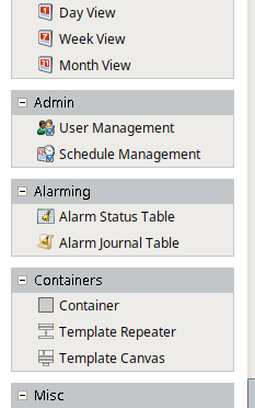

![image](https://us1.discourse-cdn.com/inductiveautomation/original/3X/2/d/2db91da65163b18dc0f74906ffa685890a60fc12.png)
It was there before but its not there anymore. Can someone tell me how I can get it back. Thanks
**Post date:** [November 11, 2021, 7:28pm UTC](https://forum.inductiveautomation.com/t/roster-management-component-not-available-anymore-in-component-palette-in-ignition-designer/52987/2 "2021-11-11T19:28:21Z")
Install the alarm notification module.
