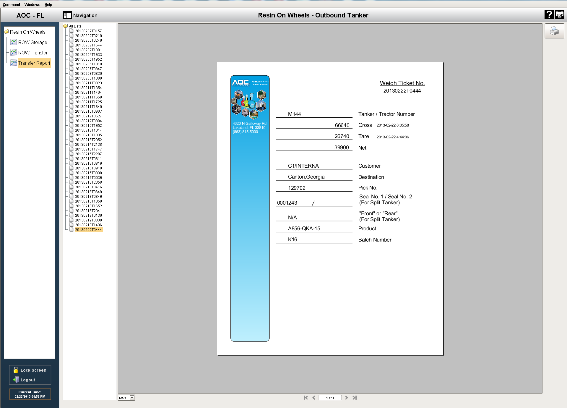

I am using a Row Selector and Report Viewer to display transaction records for a tanker tracking system. The Ignition components are working as designed, but my end users are accessing the Ignition system from a Win 8 tablet in the field.
On a tablet, the Row Selector rows are very narrow. I’ve changed the font size for the Row Selector, but it has no effect on the component. If there is a work-around to make the rows taller, please let me know.
I actually would like to put two large buttons (previous record & next record) on the Ignition window to allow them to move between the records, but I don’t see a property on the Row Selector that would let me set the selected row.
I could also build a table and use the selected table record as the input to the Report Viewer data property.
Any suggestions would be appreciated.
Philip
 ![](https://us1.discourse-cdn.com/inductiveautomation/original/2X/d/d2f0ab5254a07adf15bb8a55b426337eceed6f79.PNG)
**Author:** ![Travis.Cox](https://avatars.discourse-cdn.com/v4/letter/t/b9bd4f/32.png) [@Travis.Cox](https://forum.inductiveautomation.com/u/Travis.Cox)\
**Post date:** [February 22, 2013, 8:19pm UTC](https://forum.inductiveautomation.com/t/row-selector-on-tablet/5914/2 "2013-02-22T20:19:11Z")
Right now the font property doesn’t do anything. I will add a request in to get that fixed. In the meantime you can add the following script to the internalFrameActivated event of the window to make the font bigger:`from java.awt import Font
tree = system.gui.getParentWindow(event).getComponentForPath('Root Container.Row Selector').getViewport().getView()
tree.setFont(Font("Dialog", Font.PLAIN, 20))`

Thanks Travis, that worked perfectly.
**Author:** ![samson.miller](https://avatars.discourse-cdn.com/v4/letter/s/e9bcb4/32.png) [@samson.miller](https://forum.inductiveautomation.com/u/samson.miller)\
**Post date:** [April 1, 2013, 4:52pm UTC](https://forum.inductiveautomation.com/t/row-selector-on-tablet/5914/4 "2013-04-01T16:52:12Z")
This bug has been fixed for version 7.5.7.
