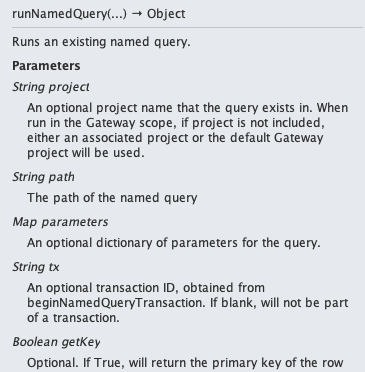

What version are you using? The docs have not had time to catch up yet, but newer versions of Ignition (\>=8.0.4) actually introduced transactional queries, so the `0` is being interpreted as the `tx` argument.
![33%20PM](https://us1.discourse-cdn.com/inductiveautomation/original/2X/7/73c92c2a22bd9cd3a50ab5029319a84eb9d02072.png)
You have several options available to you, but what I recommend is simply modifying your code to:

That is it. We are currently running 8.0.4. The manual does not say anything about “tx”, but if I do a ctrl+spacebar I see the tx parameter. Long story short always send named parameters and then you do not have to rely on the positioning to be correct.
