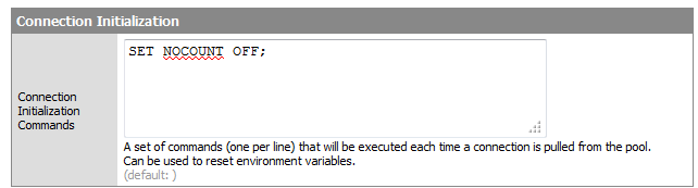

We have started getting the following error on a window that has been working just fine for months with no resent changes. any ideas what would be causing it?

Caused by: com.inductiveautomation.ignition.client.gateway_interface.GatewayException: SQL error for "INSERT INTO dbo.tblPackLineCheck (PACKAGEID,CHECKTIME,VJC,Notes,LineSpeed) VALUES (?,?,?,?,?)": A result set was generated for update.

Caused by: com.microsoft.sqlserver.jdbc.SQLServerException: A result set was generated for update.

Ignition v7.3.3 (b570)
Java: Sun Microsystems Inc. 1.6.0_17
**Author:** ![Jonathan](https://avatars.discourse-cdn.com/v4/letter/j/aeb1de/32.png) [@Jonathan](https://forum.inductiveautomation.com/u/Jonathan)\
**Post date:** [February 10, 2012, 6:09pm UTC](https://forum.inductiveautomation.com/t/runprepstmtgetkey-error/3976/2 "2012-02-10T18:09:16Z")
The solution is to add “SET NOCOUNT OFF” in the advanced settings of the database connection on the gateway.
