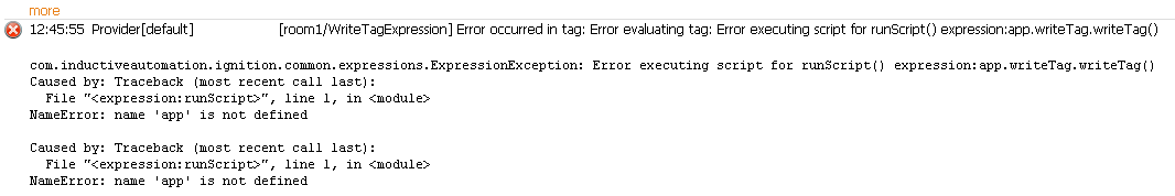

Is it possible to put a runScript who call a function module in a tag?
The call works well in a button and a link property. But does not work in the expression of a tag, this is my error image.
Thanks.
 ![](https://us1.discourse-cdn.com/inductiveautomation/original/2X/1/1906ac1e9094c2ef6b725777e956a35362fbaf8b.png)
**Post date:** [July 9, 2012, 3:20am UTC](https://forum.inductiveautomation.com/t/runscript-in-tag-expression/4786/2 "2012-07-09T03:20:45Z")
No, it’s not possible right now.
Tags are global (gateway) scoped, whereas your script modules are project scoped, so they can’t interact. We’ve got a couple different ideas to address this, but I don’t have a timeline on when they will be implemented.
