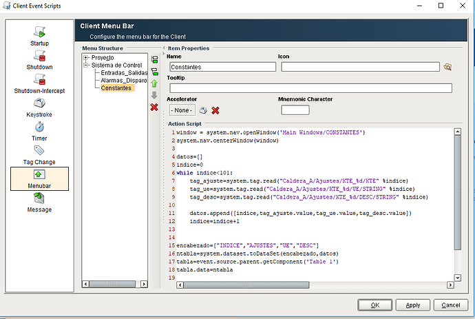

Hi,
I’m trying to run a script in the Client Event Scripts (Menubar) and I got this error and I don’t know what does it mean.
Traceback (most recent call last):
File “event:menu:Constantes”, line 17, in
NameError: name ‘event’ is not defined

Ignition v7.9.7 (b2018032914)
Java: Oracle Corporation 1.8.0\_181
 ![](https://us1.discourse-cdn.com/inductiveautomation/original/2X/3/3fb6b8212ffc86fba164c82fef8cbf99fe28ac6a.png)
Can anybody help me please? 🙏

In line 17 you’re calling event.source.parent.getComponent(), but the menubar scripts don’t get an event parameter, so event is undefined. Sounds like you wanted this script on a button in a window instead?
**Author:** ![rroca](https://avatars.discourse-cdn.com/v4/letter/r/43a26b/32.png) [@rroca](https://forum.inductiveautomation.com/u/rroca)\
**Post date:** [October 12, 2018, 2:22pm UTC](https://forum.inductiveautomation.com/t/runtimemenu-jymenuitem-scripterror/20123/3 "2018-10-12T14:22:13Z")
Hi Kathy,
Exactly! I was using that script on a button but now I want to use it in the menu bar, how can I do that?
**Author:** ![KathyApplebaum](https://sea1.discourse-cdn.com/inductiveautomation/user_avatar/forum.inductiveautomation.com/kathyapplebaum/32/7261_2.png) [@KathyApplebaum](https://forum.inductiveautomation.com/u/KathyApplebaum)\
**Post date:** [October 12, 2018, 2:43pm UTC](https://forum.inductiveautomation.com/t/runtimemenu-jymenuitem-scripterror/20123/4 "2018-10-12T14:43:14Z")
You can’t access a window’s components from a menubar, so you’ll need to rethink what you’re trying to do here. You might need to put the data into a tag that’s bound to the table instead of directly putting it in the table.
**Post date:** [October 12, 2018, 3:14pm UTC](https://forum.inductiveautomation.com/t/runtimemenu-jymenuitem-scripterror/20123/5 "2018-10-12T15:14:37Z")
Well, you have the window that presumably contains the table, so you can replace `event.source.parent` with `window.rootContainer`.
Side note: consider doing this script in window, not in the caller of the window, so it works no matter how you open int. And you really should be using `system.tag.readAll()`, not individual `read()` calls.
